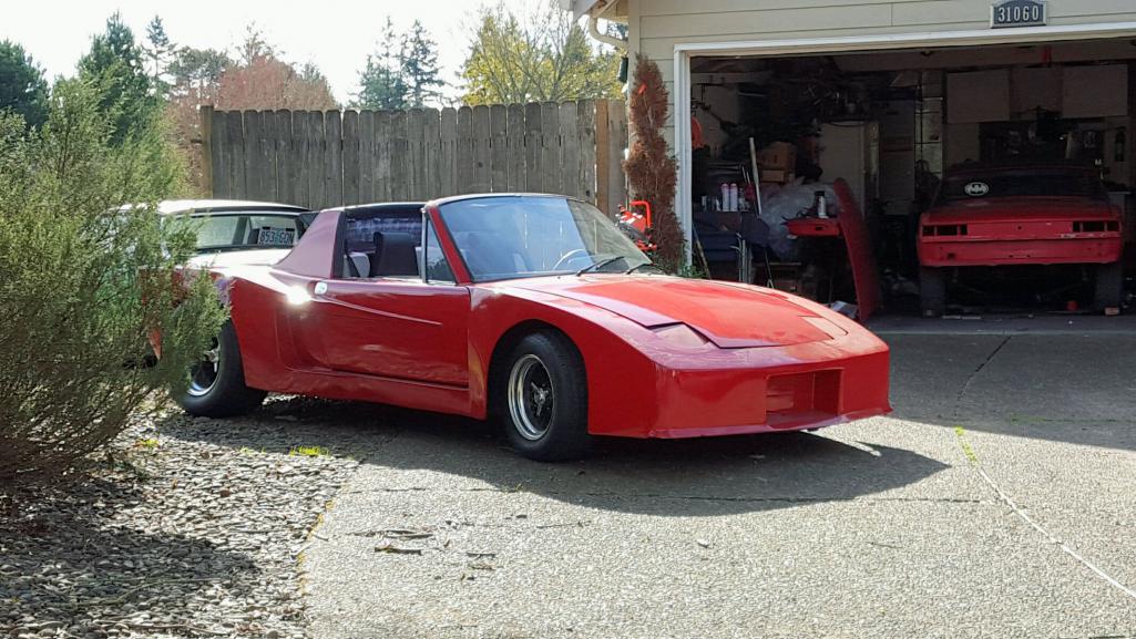

Looking forward to working on this project so I can drive my own car to WCR 2016Attached Image

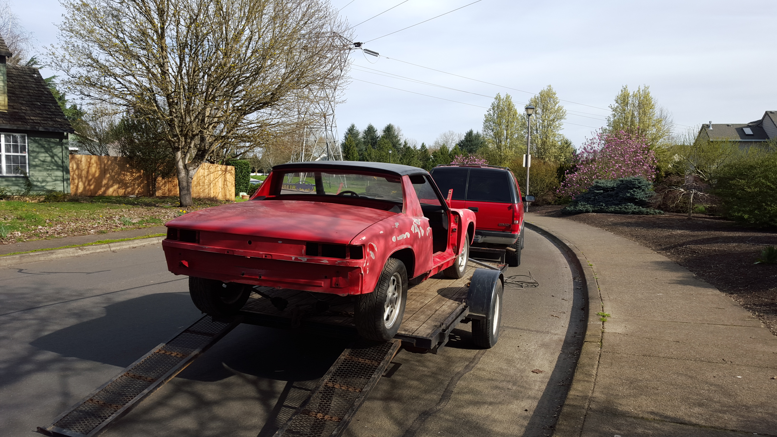

Coming and going. Got the 72 home to complete the body work and prep for paint. Lucas has been busy this week with with the DA sander, stud welder and dent puller.
Sent the wide body out to fix the wheel spacer issue and bent trailing arm. May be able to get both cars to West Coast Rally
