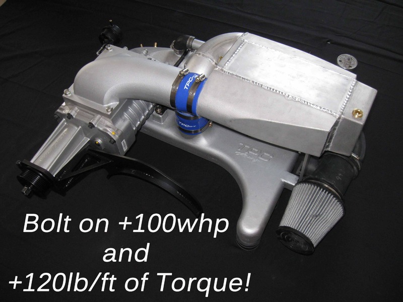

Tune the exhaust - Check... I already have the headers .
Hot Cams - not too hot, just the equivalent to factory RS cams.
Ditch the cat - no place to put one on a 914 (IMG:style_emoticons/default/biggrin.gif)
Tune the chip - already planned....
Bigger p&c - that's covered...
And for future mods I am looking at a hotwire mass airflow sensor conversion.
And for really, really stupid horsepower in a 914, I could spend the 9 grand to put this on:
(IMG:http://www.914world.com/bbs2/uploads_offsite/www.tpcracing.com-1143-1459082796.1.jpg)
Adds 100 HP
Not going to happen during this build. I am already getting ambitious enough with what I am doing.
But maybe someday..... (IMG:style_emoticons/default/idea.gif)
