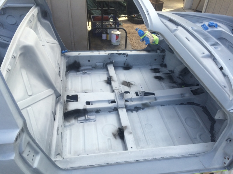

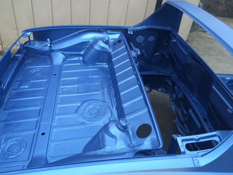

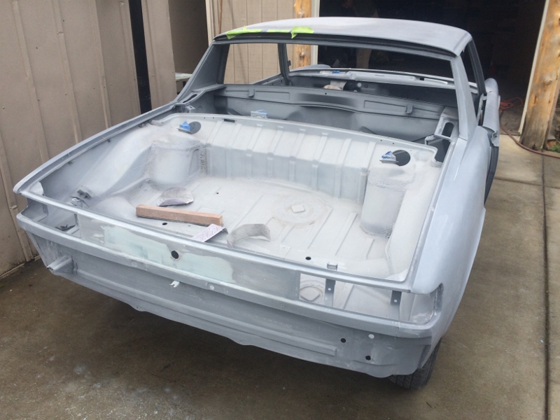

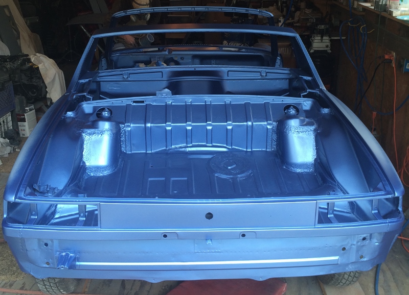

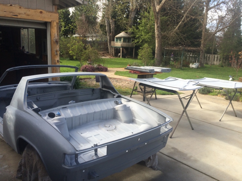

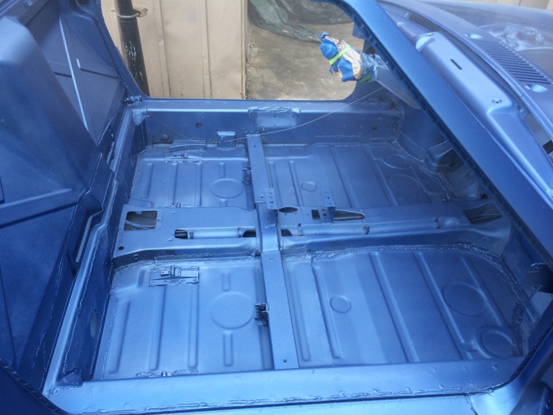

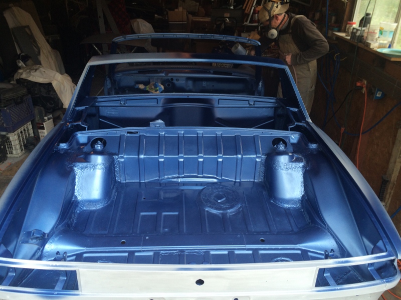

Painting Begins
I can't wait to post these photos. We are half-way through the painting process doing the interior first, two coats paint and two coats clear-coat. We decided on a non-stock color, a Honda Integra B97M code color. It's a pearl, which is mica rock, in the old days, it was made with fish scales, much easier to paint with the modern paint, but still shows every flaw. I am starting to see bumps I didn't know were there.
Blue Color survey post
Painting Notes/Tips
- The guide coat is very important throughout the paint prep process. This is a thin coat of mist sprayed over the primer to create dots or texture that reveals low spots and where you've sanded. It's particularly important for wet sanding. We used 400 grit 3M paper for wet sanding and could get away with it because of the high solids in the paint.
- Foam sanding blocks work very well.
- Use the green masking tape. The glue withstands the chemicals in the paint better than blue. blue is ok for priming, but must be changed out for the paining. Better to use the green.
- Put a little dawn dish soap in the water when wet sanding. Dawn is a great cleaner for the painting process.
- Spray water down on the ground before priming and paining to remove static discharge and keep the paint from sticking to the cement.
- Use lacquer thinner for solvent.
- Mix hardeners exactly, but reducers are up to the painter.
- Buy a small amount of test paint and spray it out with one, two, and three coats, with clear coat over the top, because the paint varies considerably with the number of coats and methods of spray. Also, photos on the internet vary widely depending on lighting conditions.
- There is a face coat and side cote tone that varies between light and shadow. The difference in tones is important as you will see it in the curves of the car.
- More to follow as I remember them (Feel free to add your painting tips)
Pictures:
Our color trials. The lower colors are a candy version that we will use for the rocker panels.
(IMG:http://www.914world.com/bbs2/uploads_offsite/i1301.photobucket.com-17072-1459118682.1.jpeg)
(IMG:http://www.914world.com/bbs2/uploads_offsite/i1301.photobucket.com-17072-1459098112.1.jpg)
(IMG:http://www.914world.com/bbs2/uploads_offsite/i1301.photobucket.com-17072-1459098112.2.jpg)
(IMG:http://www.914world.com/bbs2/uploads_offsite/i1301.photobucket.com-17072-1459098113.3.jpg)
(IMG:http://www.914world.com/bbs2/uploads_offsite/i1301.photobucket.com-17072-1459098113.4.jpg)
(IMG:http://www.914world.com/bbs2/uploads_offsite/i1301.photobucket.com-17072-1459098113.5.jpg)
(IMG:http://www.914world.com/bbs2/uploads_offsite/i1301.photobucket.com-17072-1459098114.6.jpg)
(IMG:http://www.914world.com/bbs2/uploads_offsite/i1301.photobucket.com-17072-1459098114.7.jpg)
These pictures were taken before the clear coat was applied, which really makes the paint pop.

R_u_dd   Painting Begins I can't wait to post these ph...   Mar 27 2016, 11:01 AM
R_u_dd   We got some paint on the panels yesterday and clea...   Apr 2 2016, 11:27 PM
