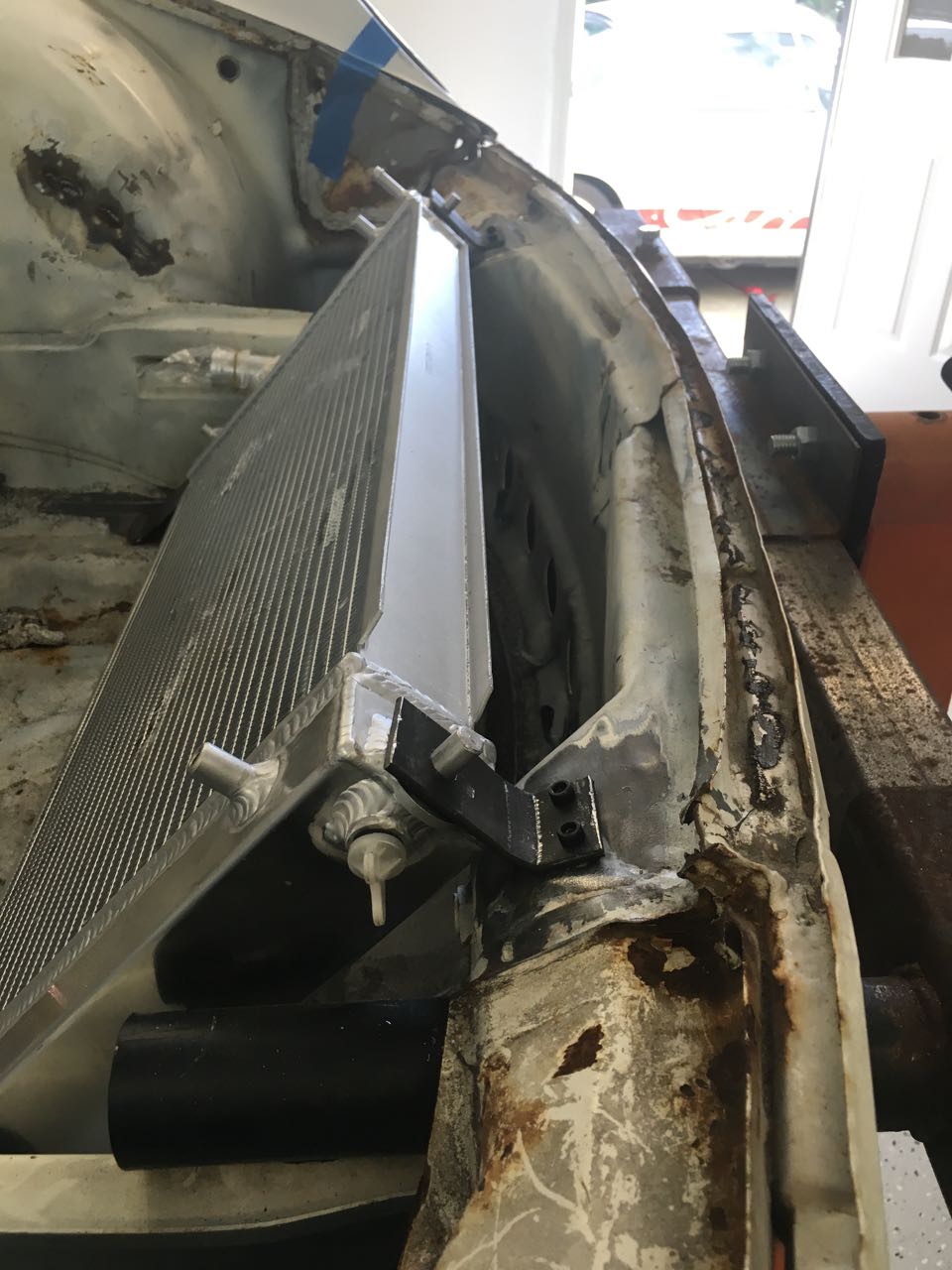

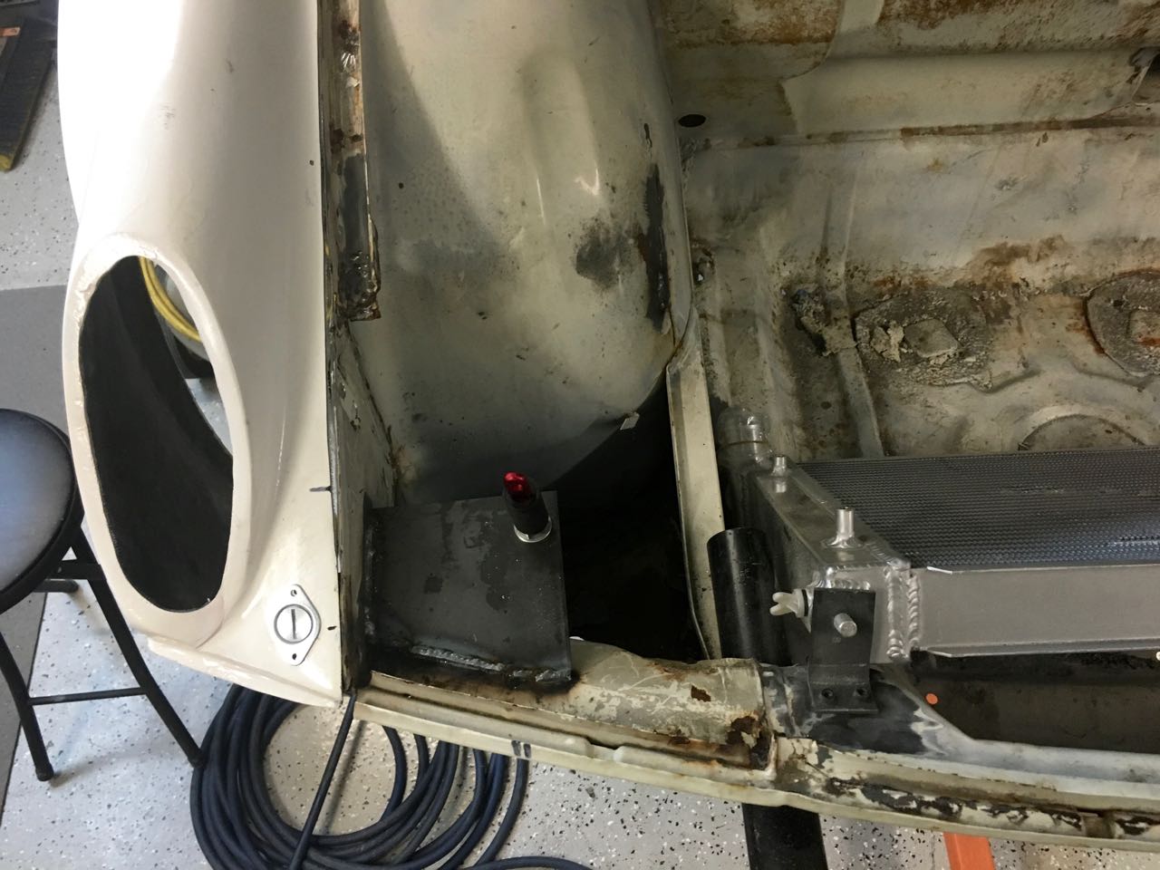

Bought a radiator!
The eBay Celica Gt radiator that was suggested to me is a *perfect* fit.

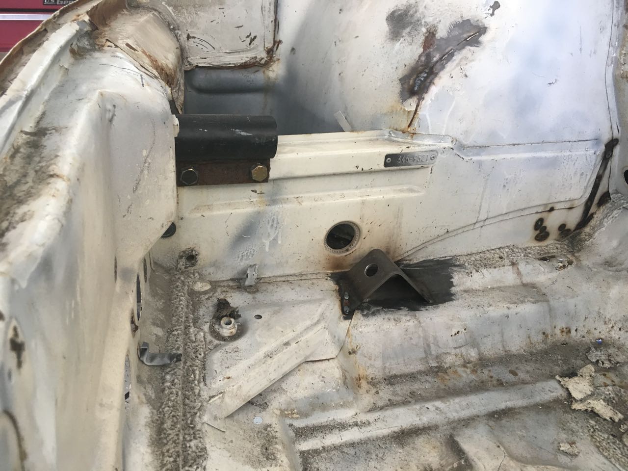

Mounting was easy enough: Bend metal, drill hole, weld in, repeat.
The feet are welded in, the top tabs are backed by riv-nuts

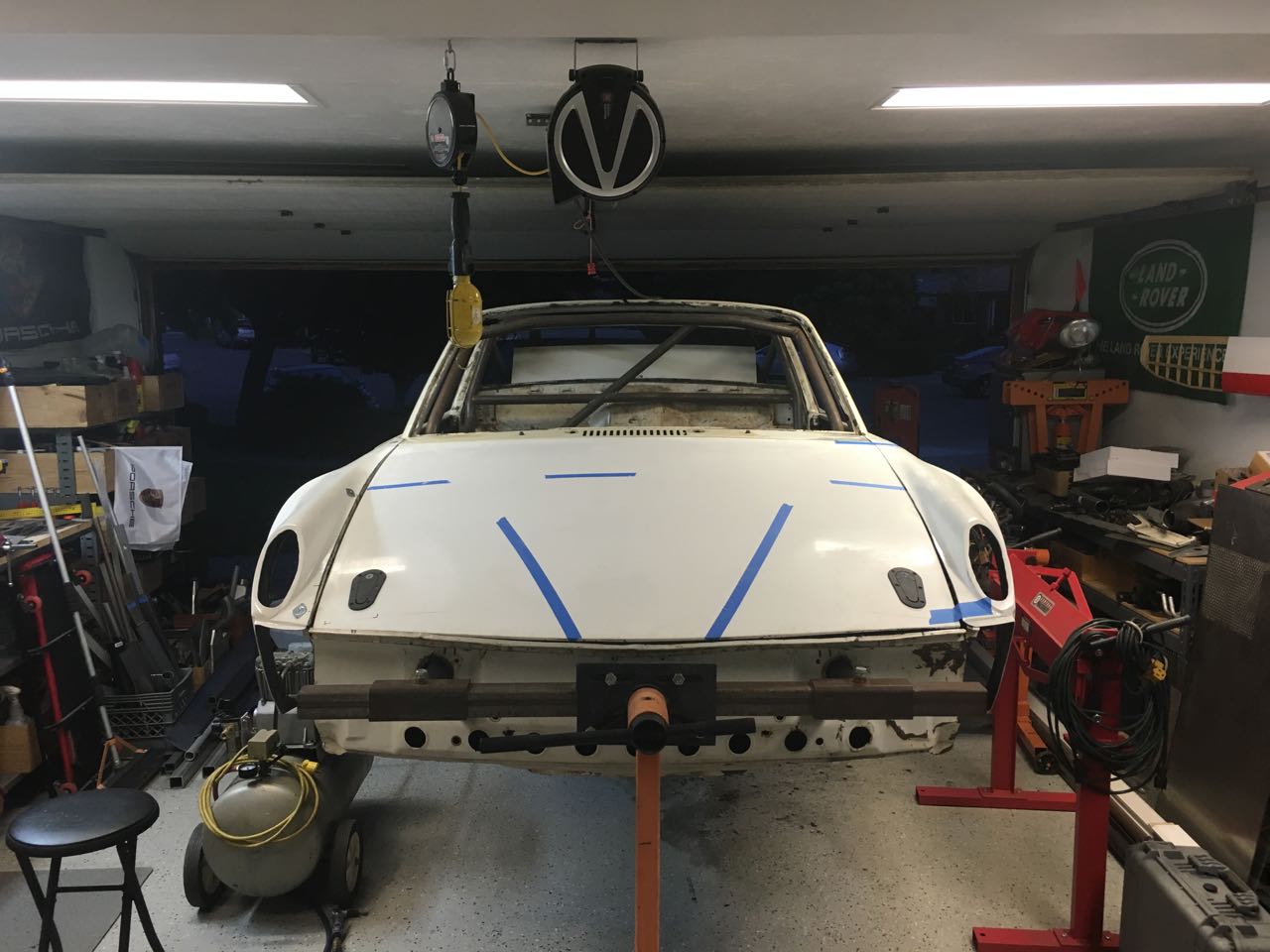

Also got around to mounting the new hood. The latches are basic eBay models, super affordable, nothing special. I really like the look of them though, they look like business. Getting them all squared up on the hood was probably the hardest part, welding the backing plates wasn't too bad.

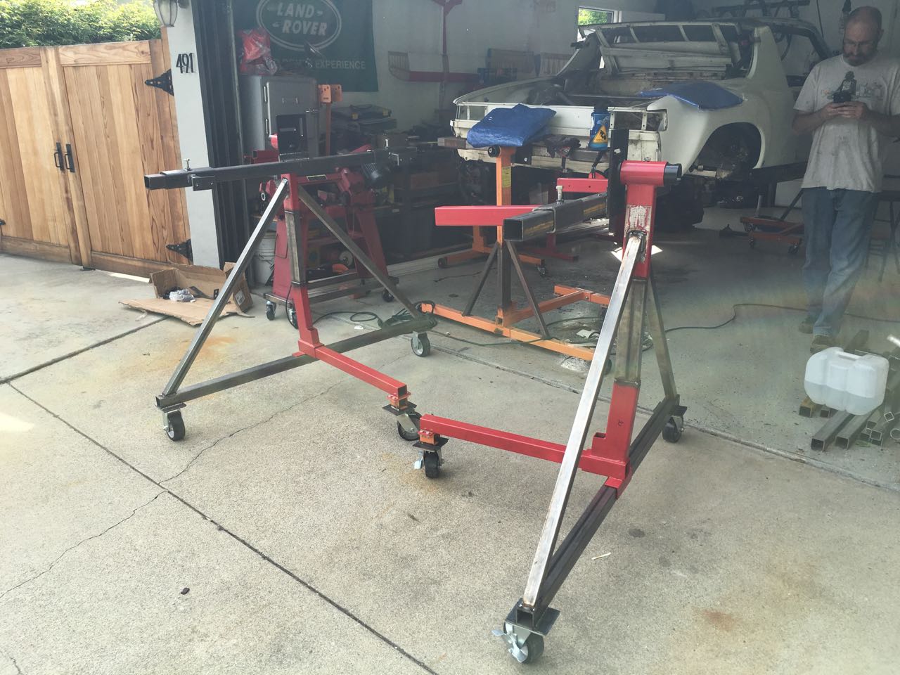

My friend Alex gave me all his parts to build the rotisserie that the 914 is on right now. He needed one to put his Z project on, and he refused to ask me to take the 914 off the stand, so we bought a whole new set of parts and built another one. The new red one is so much better than the orange one my car is on, its got probably $100 worth of casters on it, its so easy to move around. He's happy, so Im happy.

So yeah, next update will be all the driver-side bodywork, then I'll probably cut the hood open and route the radiator cooling out of it. I'll probably work up some aluminum shrouding, something simple to keep the water out of the tub when washing the car. It'll take some time but I think it'll be worth it. Then the rear trunk, going to use J-West mounts and the same black racing latches. Eventually tail-lights too, I plan to make my own.
