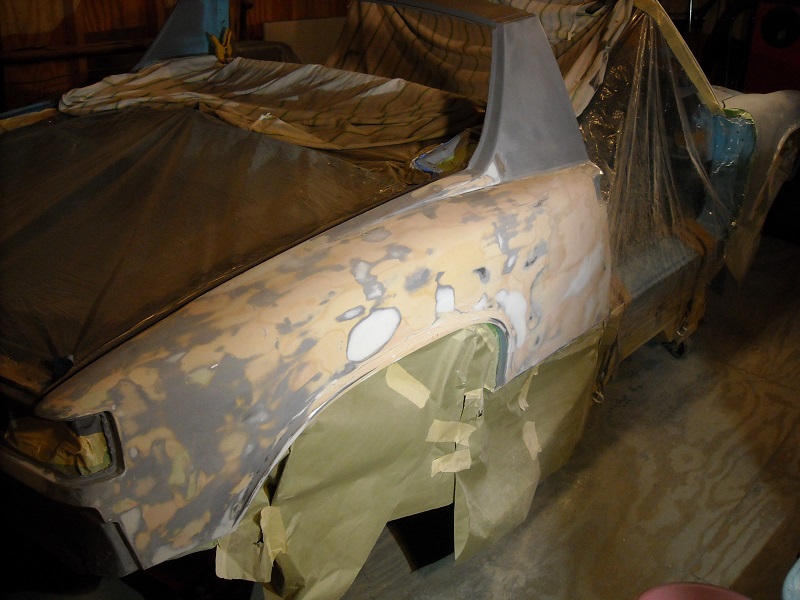

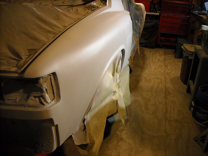

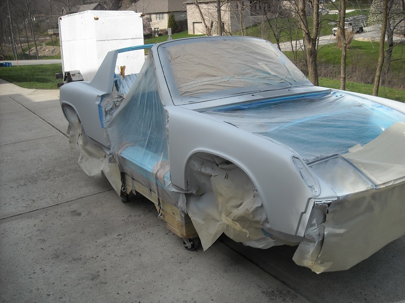

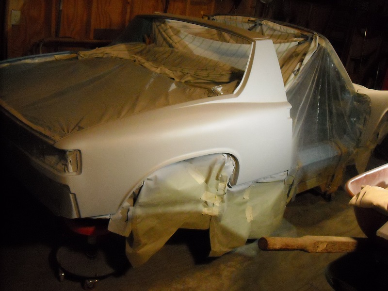

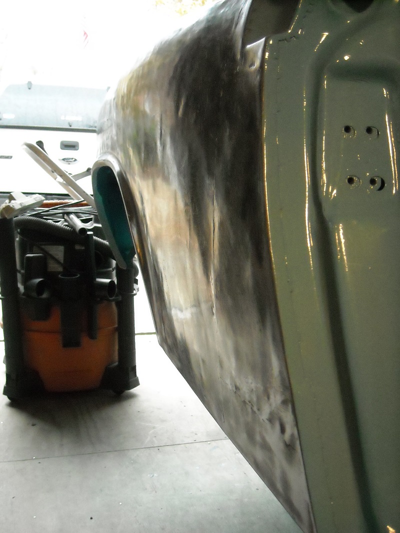

Still doing body work. I have the pass side in good shape now, at least to my untrained eye.
I have gone from the raw pieced together quarter panel, the result of flaring the fenders.
worked it to this mottled looking mess.
and finally to this much sexier looking shape.
So body work on the pass side is pretty much done. hope it looks good when I get the final paint on it. I still need to revisit the drivers side and do a little more shaping on the fender lips. Many, many hours into this.

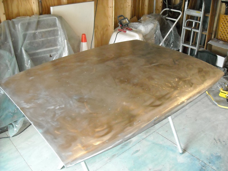

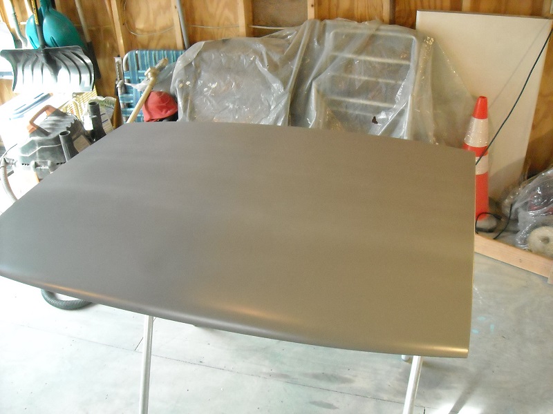

Stripped the 35 year old acrylic lacquer paint off of the rear trunk lid, it looks good underneath. only a little work needed here.
shot some epoxy on it before I start.

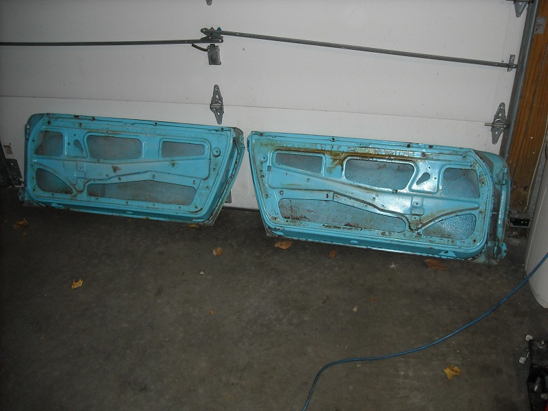

Have the doors stripped out and will be having them blasted, I know there is a bit of previous bodywork hiding under there, still have to scrap out the old sound deadener before blasting.

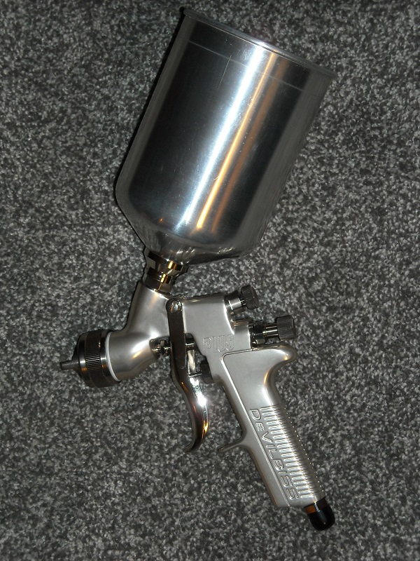

After much internal debate I finally decided on what type of paint I am going to use. I am going with PPG Concept, Single stage
So I bit the bullet and purchased my paint. $$$
And decided on a big boy spray gun to go with it. DeVilbiss 670+. I don't want to shoot this paint with a HF gun.

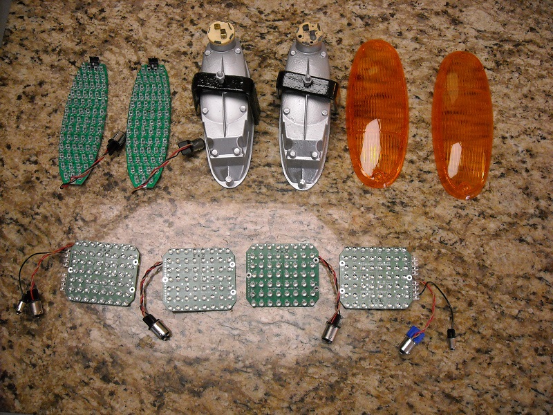

Spoke for the LED front and rear lights. Thanks Jerry.
also refinished my turn signal buckets and bought new lens for them. and grabbed these LEDs for the reverse lights.

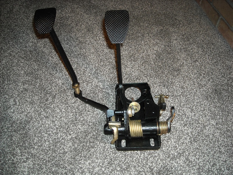

Had Bruce Stone redo my pedal set, and the turn around time was fantastic!! Thanks Bruce.
