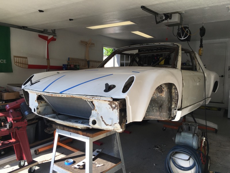

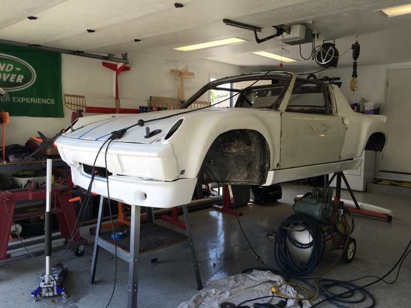

Open a hole.
Close a hole.
Man, that lower lip is going to need all kinds of fab work to get right. Its just mocked up for now.
JWest trunk mount kit arrived today too, so trunk can be mounted up.
