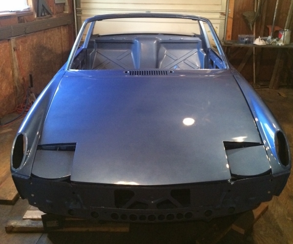

Current Look:
(IMG:http://www.914world.com/bbs2/uploads_offsite/www.imgur.com-17072-1607919164.1.jpg)
(IMG:http://www.914world.com/bbs2/uploads_offsite/www.imgur.com-17072-1607919164.2.jpg)
(IMG:http://www.914world.com/bbs2/uploads_offsite/www.imgur.com-17072-1607919165.3.jpg)
(IMG:http://www.914world.com/bbs2/uploads_offsite/i1301.photobucket.com-17072-1459666779.1.jpg)

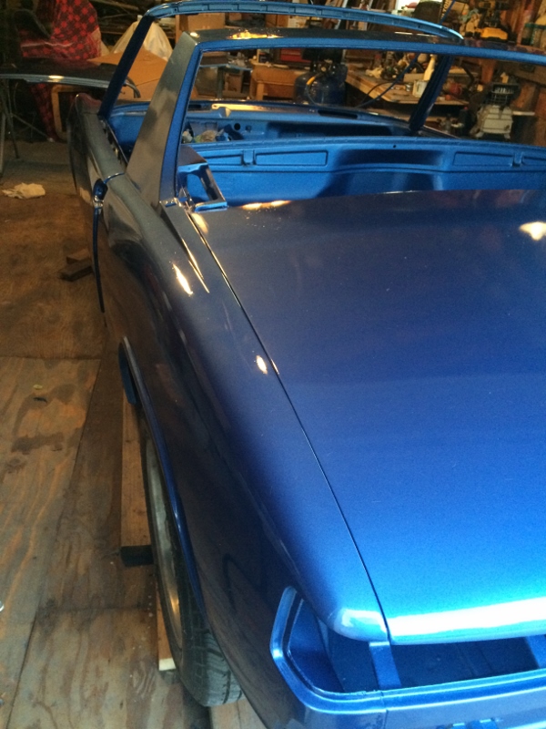

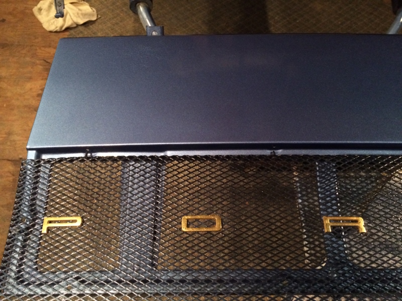

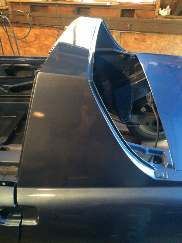

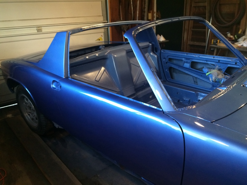

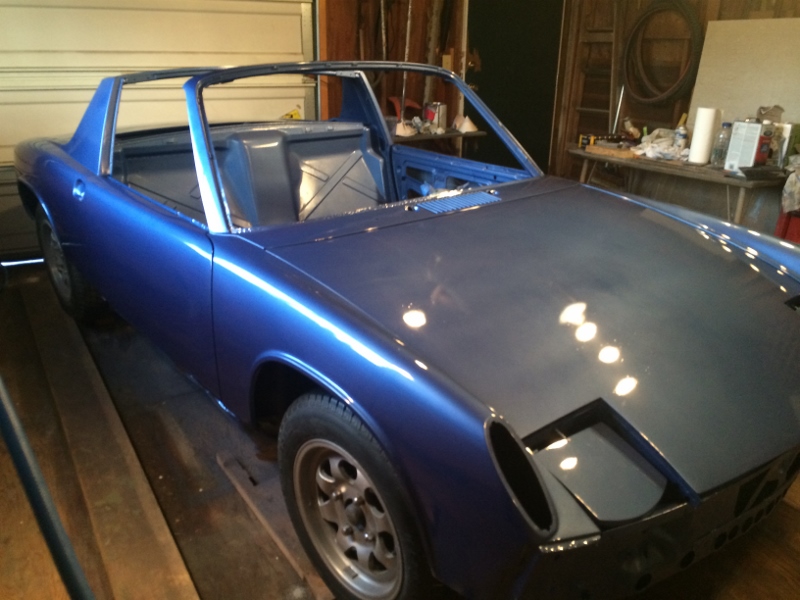

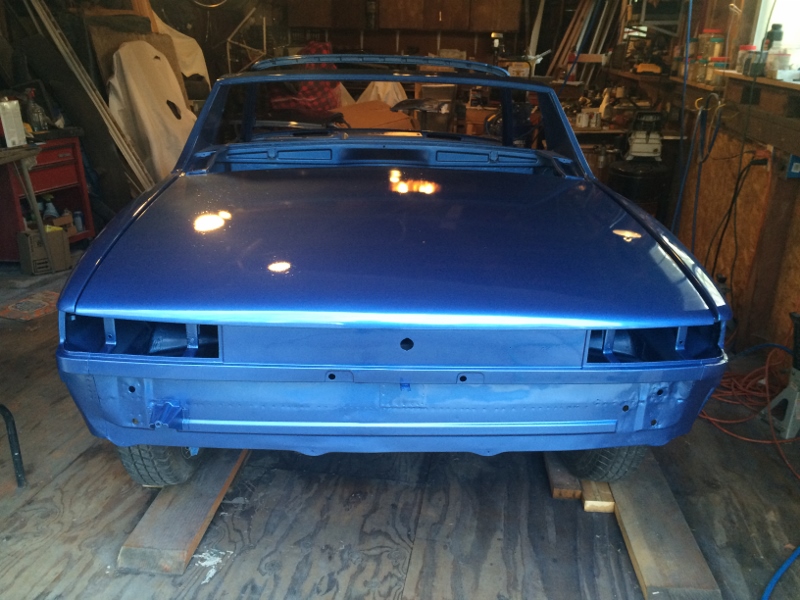

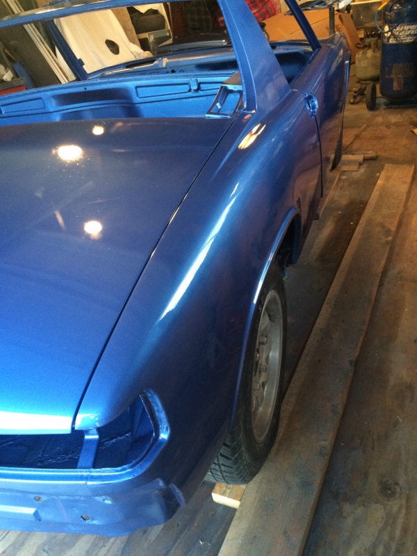

We got some paint on the panels yesterday and clear coat today. Two coats paint, one coat pearl, 4 coats clear. We need to do some cutting and buffing yet. There's still orange peel and quite a bit of texture to be buffed. But, again, I can't wait to post pix, so here they are...
The color is amazing, but you can't see it as well with these pictures taken inside. I will have to push it out there for pix when the pollen stops flying and we are done with the paint.
(IMG:http://www.914world.com/bbs2/uploads_offsite/i1301.photobucket.com-17072-1459666913.1.jpg)
(IMG:http://www.914world.com/bbs2/uploads_offsite/i1301.photobucket.com-17072-1459661231.1.jpg)
(IMG:http://www.914world.com/bbs2/uploads_offsite/i1301.photobucket.com-17072-1459661231.2.jpg)
(IMG:http://www.914world.com/bbs2/uploads_offsite/i1301.photobucket.com-17072-1459661231.3.jpg)
(IMG:http://www.914world.com/bbs2/uploads_offsite/i1301.photobucket.com-17072-1459661231.4.jpg)
(IMG:http://www.914world.com/bbs2/uploads_offsite/i1301.photobucket.com-17072-1459661231.5.jpg)
(IMG:http://www.914world.com/bbs2/uploads_offsite/i1301.photobucket.com-17072-1459661231.6.jpg)
(IMG:http://www.914world.com/bbs2/uploads_offsite/i1301.photobucket.com-17072-1459661232.7.jpg)
(IMG:http://www.914world.com/bbs2/uploads_offsite/i1301.photobucket.com-17072-1459661232.8.jpg)

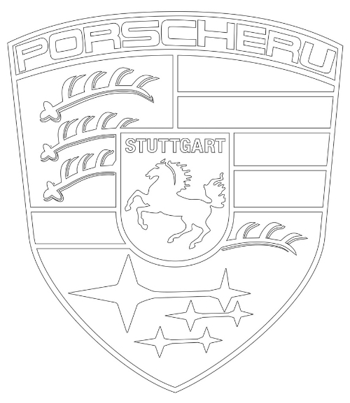

And a surprise on the way ...
(IMG:http://www.914world.com/bbs2/uploads_offsite/i1301.photobucket.com-17072-1459666913.2.jpg)
