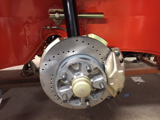

I have been making some good progress on the car this month. I have the front suspension mounted along with the steering rack.

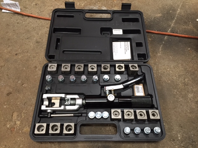

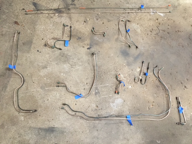

I also mounted the calipers and made all new brake lines. I used a NiCopp Nickel/Copper brakeline material since it is easy to work with and won’t corrode.

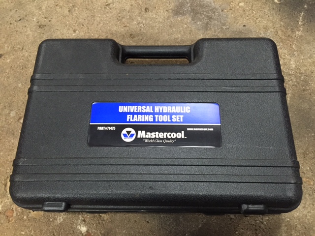

I borrowed this tool to do the ISO flaring and it work great and was easy to do.

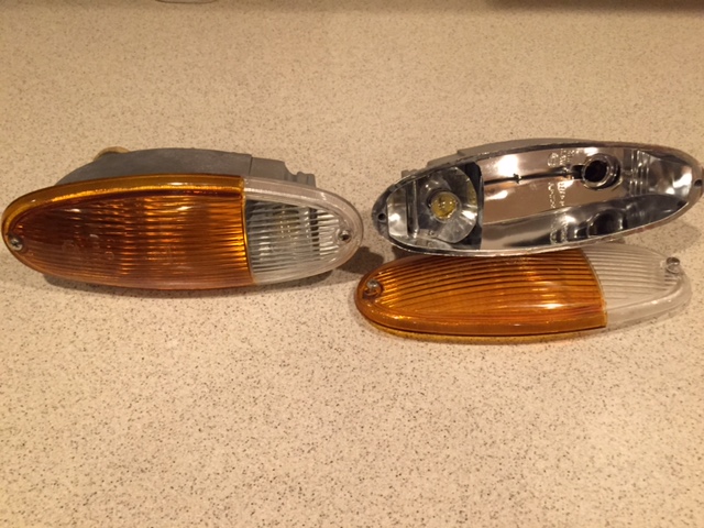

I also got the front turn signal lights cleaned up and converted to the Euro style.
