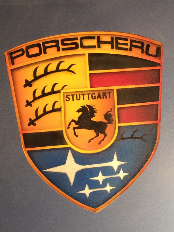

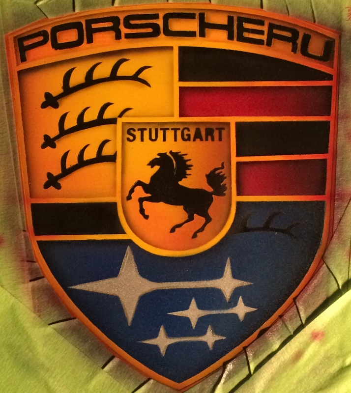

The big reveal today. Scott finished the logo. He painted this by hand with an aribrush. It's on the sail panel.
It's not a sticker believe it or not. The pictures are a little larger than life size.
