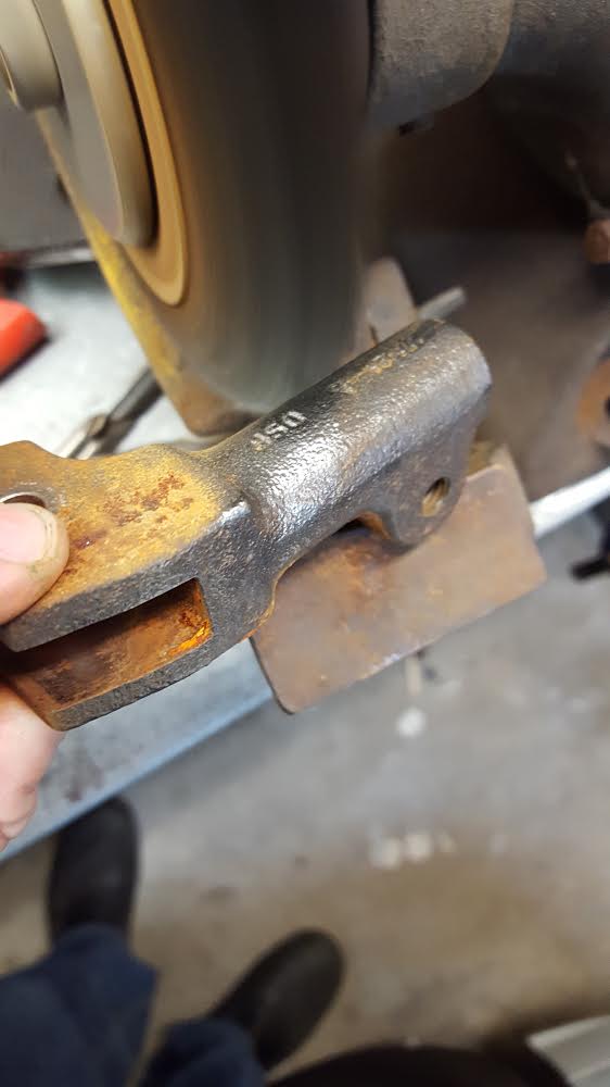

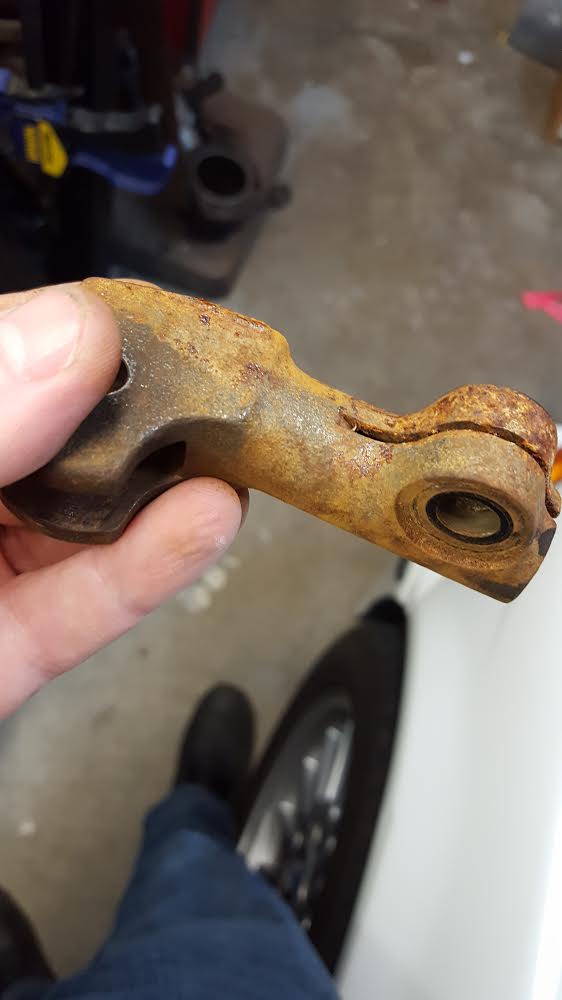

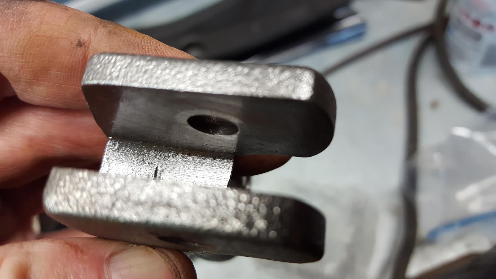

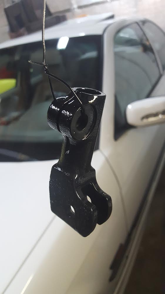

I'm going to have the taste of ground up rust in my mouth through the majority of this project.
Just a little clean up project last night. Used Metal Prep before sleeping and then primed and put a top coat on before work this AM.
I'll probably used white lithium grease on the swivel and then a little anti seize in the tube portion as I left that mostly bare metal.
