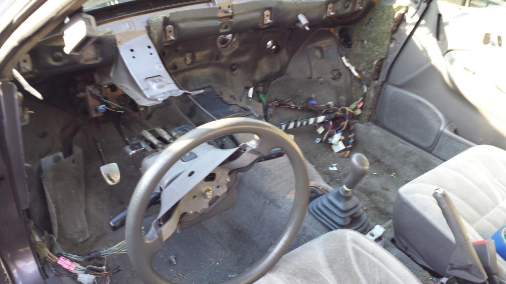

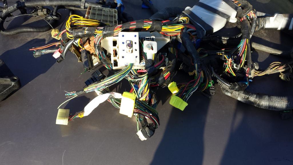

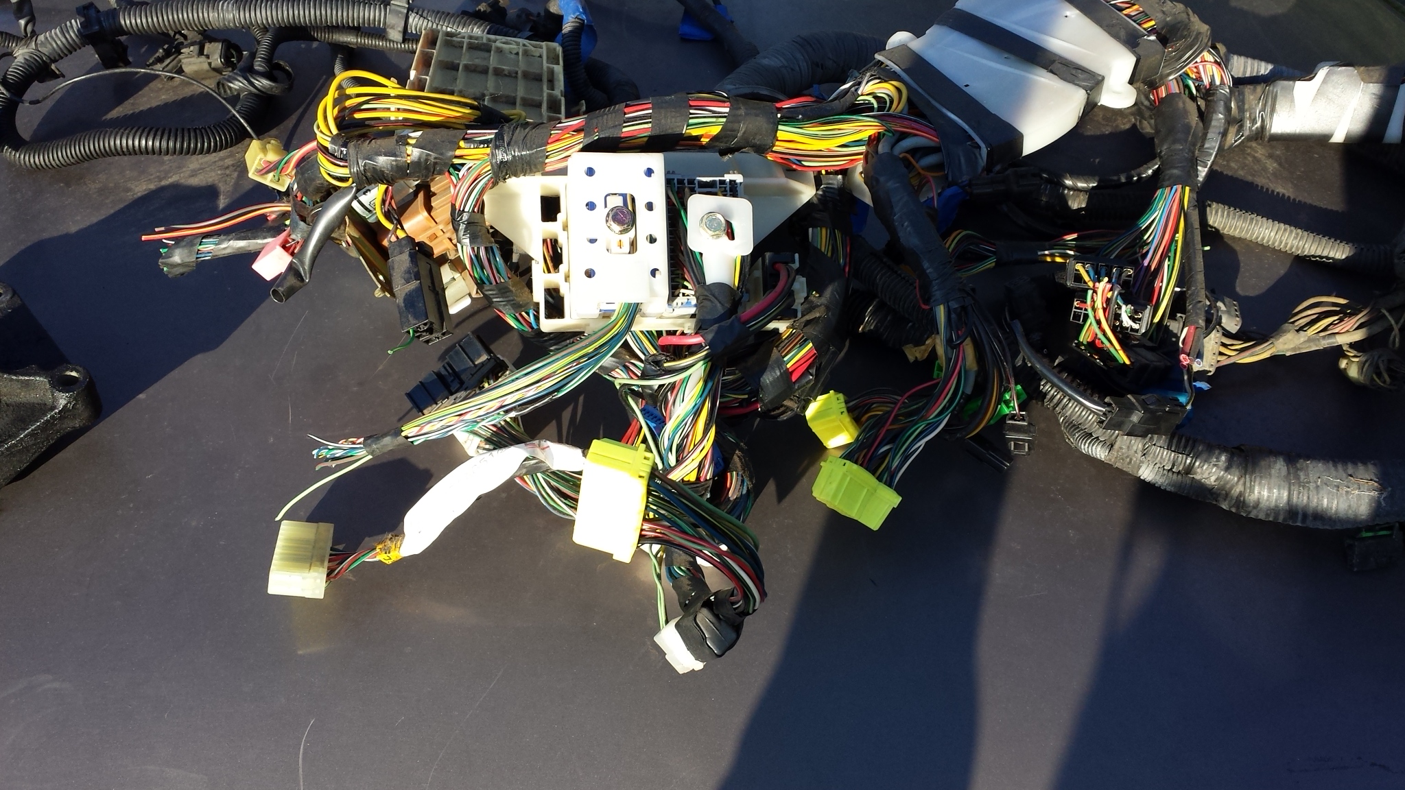

at a gas station on the way back from picking up engine, a guy asked me what kind of engine is that, i asked, the one in the trunk or the one in the car (IMG:style_emoticons/default/av-943.gif) and another guy told me about ferdinand porsche having a flat 8 cylinder car.
harness and ecu OUT (IMG:style_emoticons/default/smile.gif)
with only two small cuts to body, one one to finger and one to wrist (IMG:style_emoticons/default/rolleyes.gif)
and my hopefully to be driver 1990 subaru legacy auto awd white

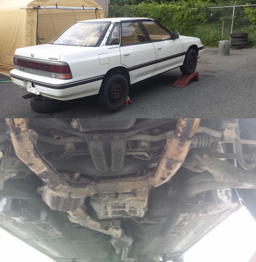

thinking about driving the white one for a while but it has TRANS BINDING which means it probably needs a new DUTY C SOLENOID, thus i am pulling the exhaust and drive shaft, so i can pull rear housing off auto awd trans, so i can get to solenoid a clutch pack. see thread about this...
http://forums.nasioc.com/forums/showthread...ghlight=binding
