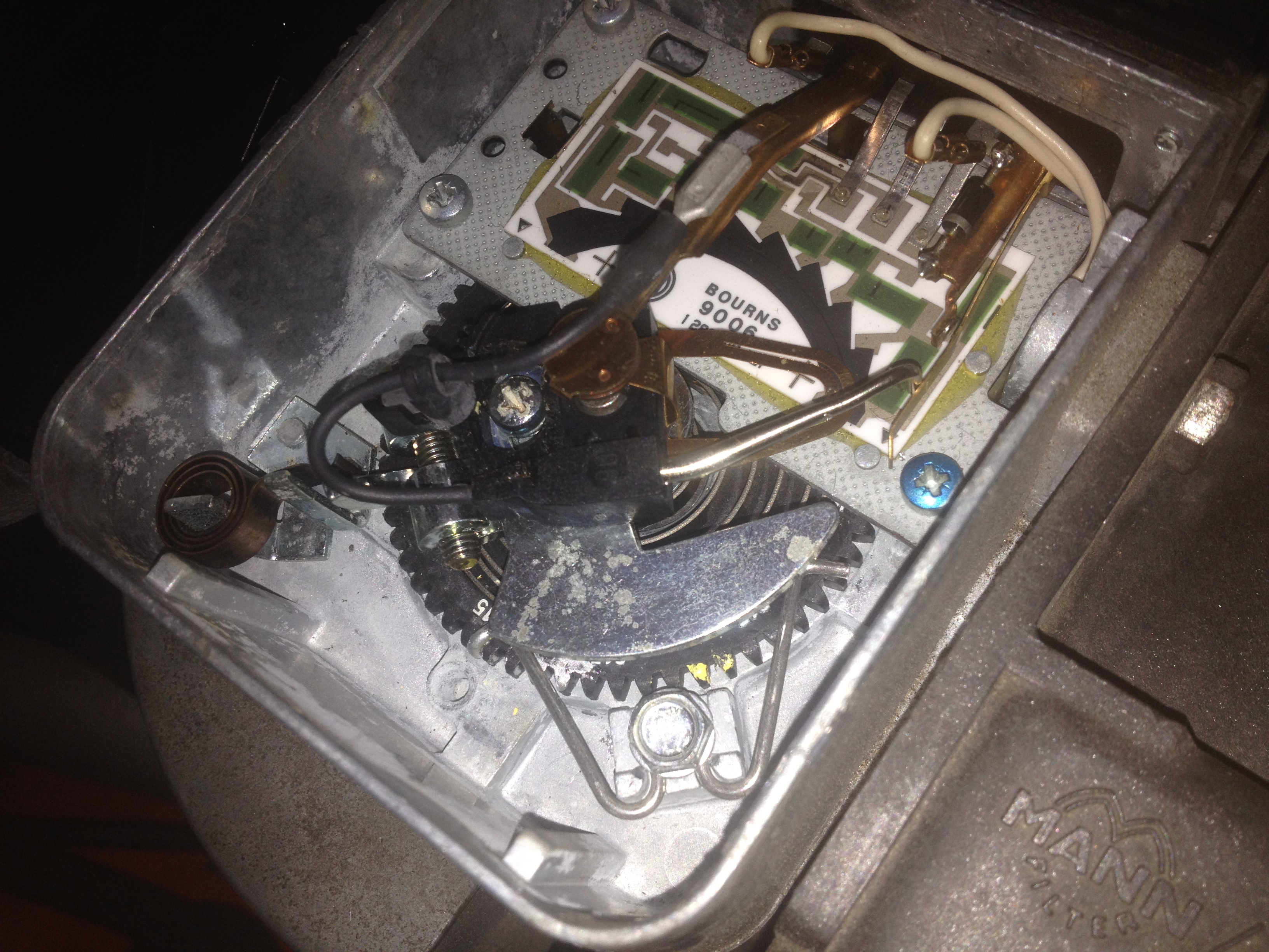

Close up photo of my AFM.... I did not remember exactly how many teeth I stopped at, but it looks like 9. I am going to go back thru the Itinerant-air-cooled instructions to see where I stand now. this thing still scares me....
Any other thoughts?

timothy_nd28   You adjusted the AFM too rich. You really need a A...   Apr 18 2016, 10:00 PM
malcolm2   You adjusted the AFM too rich. You really need a ...   Apr 19 2016, 02:55 PM
