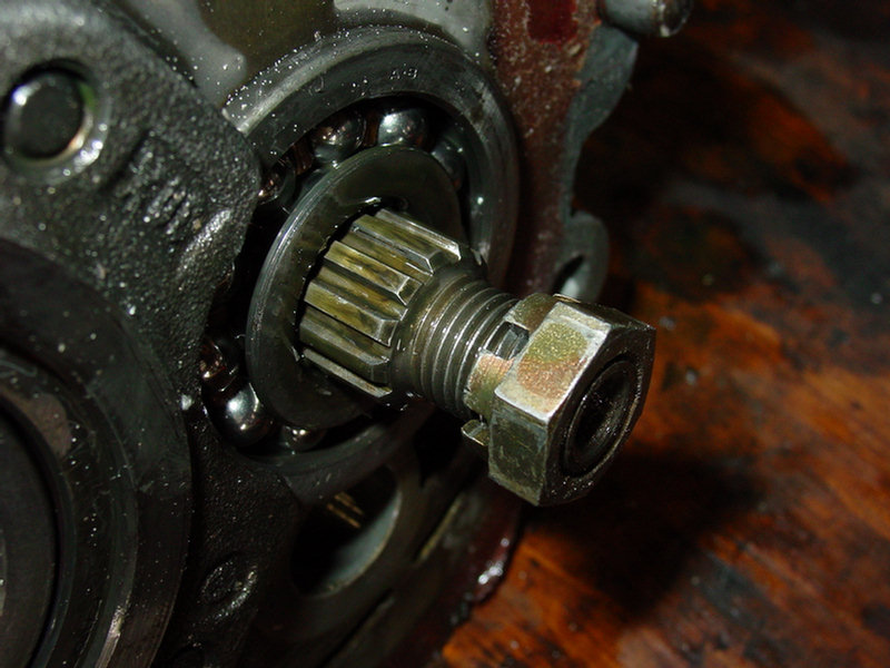

Alternate tapping the two shafts with a brass hammer, trying to get them to move together. When the nut hits the small side of first gear, stop, remove the nut, and remove the gear (a gear puller can help here, but you probably won't need it). Put the nut back on flush, and contunue.
