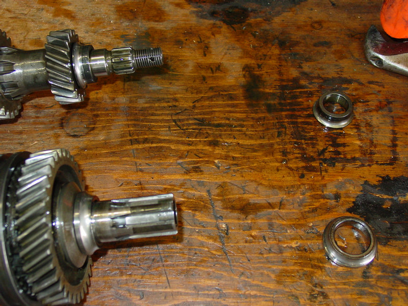

Once you get the shafts out of the intermediate plate, the two bearing races that were holding them on will fall off. In the picture here, the intermediate plate would go between the shafts and the races on the right (note matching races still on the shaft)
