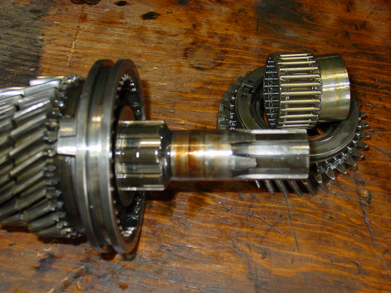

I just took apart my last transmission, and I carefully documented the disassembly with notes and pictures. I did it so I could put one back together, but I might as well post it here for all to benefit from. It is not intened to replace Red-Beard's article, more to supplement it. The parts diagrams and Red-beard's article are not enough to turn a pile of parts into a transmission. (There are three similar tapered washers that are all different thicknesses, for example) You either have to just know where everything goes, or take very good notes while disassembling. I did not fully disassemble the transmission, just the most confusing parts that usually have to come off. I left a bearing race on the input shaft, and a bearing on the pinion shaft. I did not remove the differential. Without further adoo, (I don't even try to spell french) here's step one:

Next is the second tapered washer. The washer is about 6.6 mm thick at its thickest, and the flat side is against 2nd gear. Then remove second gear and it's associated roller bearing and inner race.

bondo   Next is the second tapered washer. The washer is a...   Oct 5 2004, 05:16 PM
bondo   Now remove the 2/3 slider and its hub.   Oct 5 2004, 05:17 PM
bondo   Next 3rd gear comes off, with it's roller bear...   Oct 5 2004, 05:24 PM
bondo   Then take off the 2.5mm thick flat washer.   Oct 5 2004, 05:25 PM
bondo   Next take off 4th gear. The ridge goes against the...   Oct 5 2004, 05:27 PM
bondo   Now take off the spacer that's between 4th and...   Oct 5 2004, 05:28 PM
bondo   Then remove 5th gear (ridge goes twoards spacer)   Oct 5 2004, 05:29 PM
bondo   Now remove the 4.2mm thick flat wahser.   Oct 5 2004, 05:30 PM
bondo   The last thing to come off the pinion shaft is fou...   Oct 5 2004, 05:33 PM
