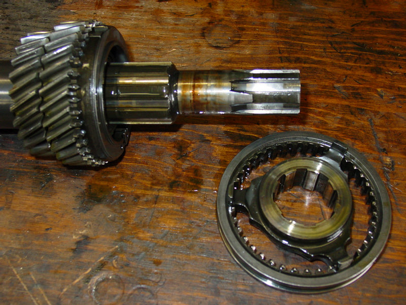

Now remove the 2/3 slider and its hub.
bondo   914 transmission disassembly   Oct 5 2004, 04:01 PM

bondo   Now remove the 2/3 slider and its hub.   Oct 5 2004, 05:17 PM
