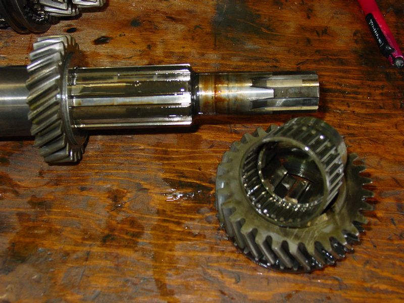

Next 3rd gear comes off, with it's roller bearing and inner race.

bondo   Next 3rd gear comes off, with it's roller bear...   Oct 5 2004, 05:24 PM
