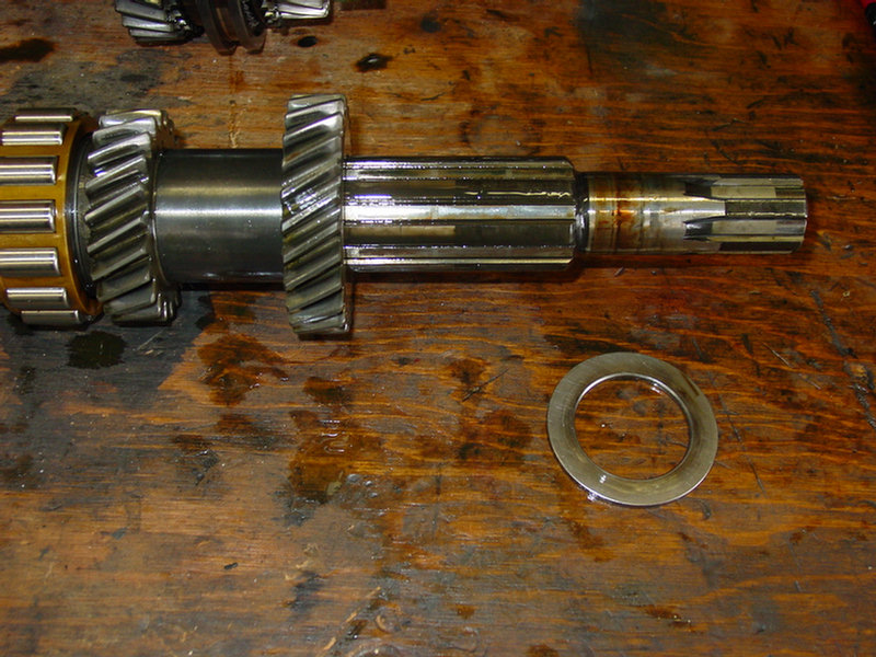

I just took apart my last transmission, and I carefully documented the disassembly with notes and pictures. I did it so I could put one back together, but I might as well post it here for all to benefit from. It is not intened to replace Red-Beard's article, more to supplement it. The parts diagrams and Red-beard's article are not enough to turn a pile of parts into a transmission. (There are three similar tapered washers that are all different thicknesses, for example) You either have to just know where everything goes, or take very good notes while disassembling. I did not fully disassemble the transmission, just the most confusing parts that usually have to come off. I left a bearing race on the input shaft, and a bearing on the pinion shaft. I did not remove the differential. Without further adoo, (I don't even try to spell french) here's step one:

Then take off the 2.5mm thick flat washer.

bondo   Next is the second tapered washer. The washer is a...   Oct 5 2004, 05:16 PM
bondo   Now remove the 2/3 slider and its hub.   Oct 5 2004, 05:17 PM
bondo   Next 3rd gear comes off, with it's roller bear...   Oct 5 2004, 05:24 PM
bondo   Then take off the 2.5mm thick flat washer.   Oct 5 2004, 05:25 PM
bondo   Next take off 4th gear. The ridge goes against the...   Oct 5 2004, 05:27 PM
bondo   Now take off the spacer that's between 4th and...   Oct 5 2004, 05:28 PM
bondo   Then remove 5th gear (ridge goes twoards spacer)   Oct 5 2004, 05:29 PM
bondo   Now remove the 4.2mm thick flat wahser.   Oct 5 2004, 05:30 PM
bondo   The last thing to come off the pinion shaft is fou...   Oct 5 2004, 05:33 PM
