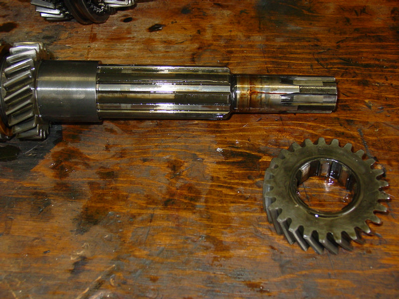

I just took apart my last transmission, and I carefully documented the disassembly with notes and pictures. I did it so I could put one back together, but I might as well post it here for all to benefit from. It is not intened to replace Red-Beard's article, more to supplement it. The parts diagrams and Red-beard's article are not enough to turn a pile of parts into a transmission. (There are three similar tapered washers that are all different thicknesses, for example) You either have to just know where everything goes, or take very good notes while disassembling. I did not fully disassemble the transmission, just the most confusing parts that usually have to come off. I left a bearing race on the input shaft, and a bearing on the pinion shaft. I did not remove the differential. Without further adoo, (I don't even try to spell french) here's step one:

Next take off 4th gear. The ridge goes against the spacer.

bondo   Next take off 4th gear. The ridge goes against the...   Oct 5 2004, 05:27 PM
bondo   Now take off the spacer that's between 4th and...   Oct 5 2004, 05:28 PM
bondo   Then remove 5th gear (ridge goes twoards spacer)   Oct 5 2004, 05:29 PM
