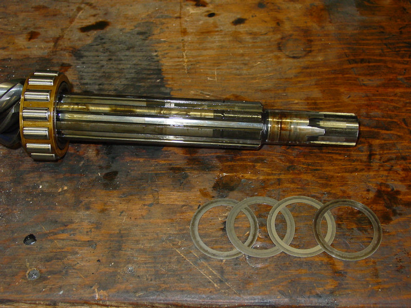

The last thing to come off the pinion shaft is four shims, about 0.3mm thick each. The number and thickness may vary between transmissions.

bondo   The last thing to come off the pinion shaft is fou...   Oct 5 2004, 05:33 PM

Red-Beard   The shims are used to line up the gears with the p...   Oct 7 2004, 05:15 AM
