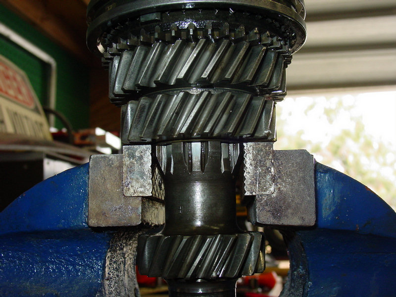

Now we move on to the input shaft. Clamp it in a vice like this: (make sure you grab the splines well, and don't pinch any gears anywhere.. Gently rotate it back and forth as you tighten the vice so it gets seated tight. Get the vice very tight.

bondo   Now we move on to the input shaft. Clamp it in a v...   Oct 5 2004, 05:35 PM
bondo   Now pound the locking tab with a screwdriver and a...   Oct 5 2004, 05:37 PM
bondo   Here's where the big-ass crecent wrench comes ...   Oct 5 2004, 05:39 PM
bondo   Once you get that nut and locking washer off, take...   Oct 5 2004, 05:42 PM
bondo   The input shaft parts come off in the following or...   Oct 5 2004, 05:54 PM
bondo   Whelp, there you have it. I hope this helps people...   Oct 5 2004, 05:56 PM
