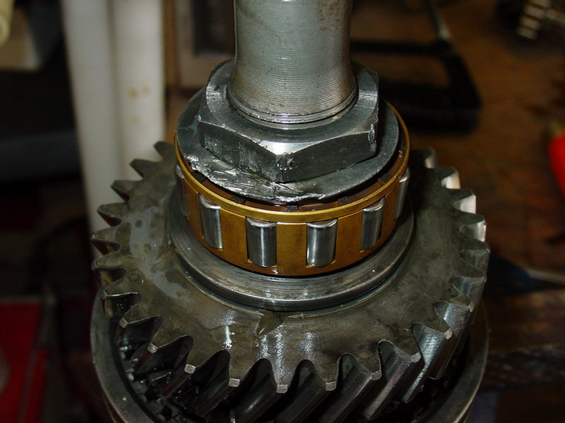

Now pound the locking tab with a screwdriver and a hammer until it flattens out like this:

bondo   Now pound the locking tab with a screwdriver and a...   Oct 5 2004, 05:37 PM
bondo   Here's where the big-ass crecent wrench comes ...   Oct 5 2004, 05:39 PM
bondo   Once you get that nut and locking washer off, take...   Oct 5 2004, 05:42 PM
