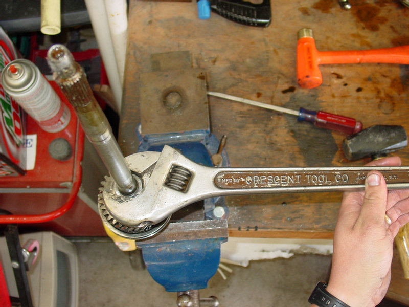

bondo   Now we move on to the input shaft. Clamp it in a v...   Oct 5 2004, 05:35 PM
bondo   Now pound the locking tab with a screwdriver and a...   Oct 5 2004, 05:37 PM
bondo   Here's where the big-ass crecent wrench comes ...   Oct 5 2004, 05:39 PM
bondo   Once you get that nut and locking washer off, take...   Oct 5 2004, 05:42 PM
