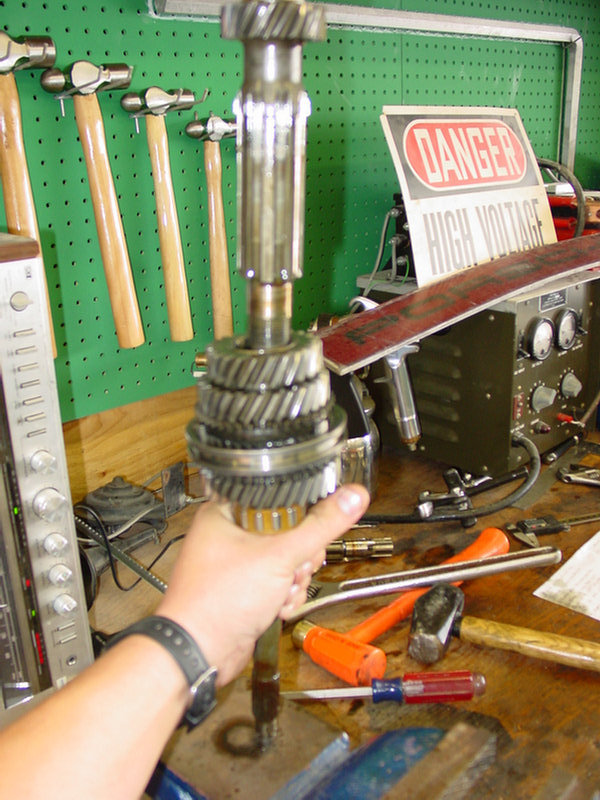

Once you get that nut and locking washer off, take the whole thing out of the vice and flip it over. Hold on to the gears and bearing, especially towards the bottom. Now pick up the whole shaft and lightly drop it on the anvil part of the vice like this: (being ready to catch the stack of bearings, washers and gears that will come loose)

bondo   Once you get that nut and locking washer off, take...   Oct 5 2004, 05:42 PM
bondo   The input shaft parts come off in the following or...   Oct 5 2004, 05:54 PM
