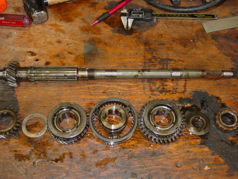

The input shaft parts come off in the following order:
Bearing (flatter side of the brass part towards 5th)
5.9mm thick tapered washer (flat side towards 5th)
5th gear, associated roller bearings and race
4/5 slider and hub
4th gear, associated roller bearings and race
2.5mm thick flat washer
3rd gear (flat side towards washer, ridge towards second gear)
2nd gear does not come off of the shaft, it's part of it.
