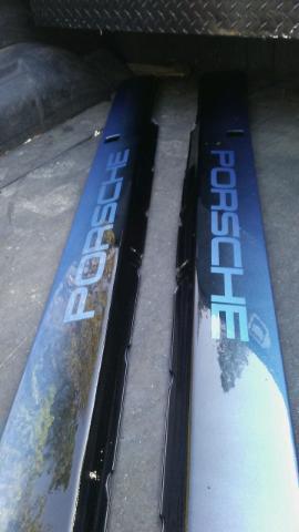

Rocker Panels (They look like a pair of skis, don't they?)
Notice the fade from blue to black on the bottom? I think it is reminiscent of the original look even though it's not correct.
