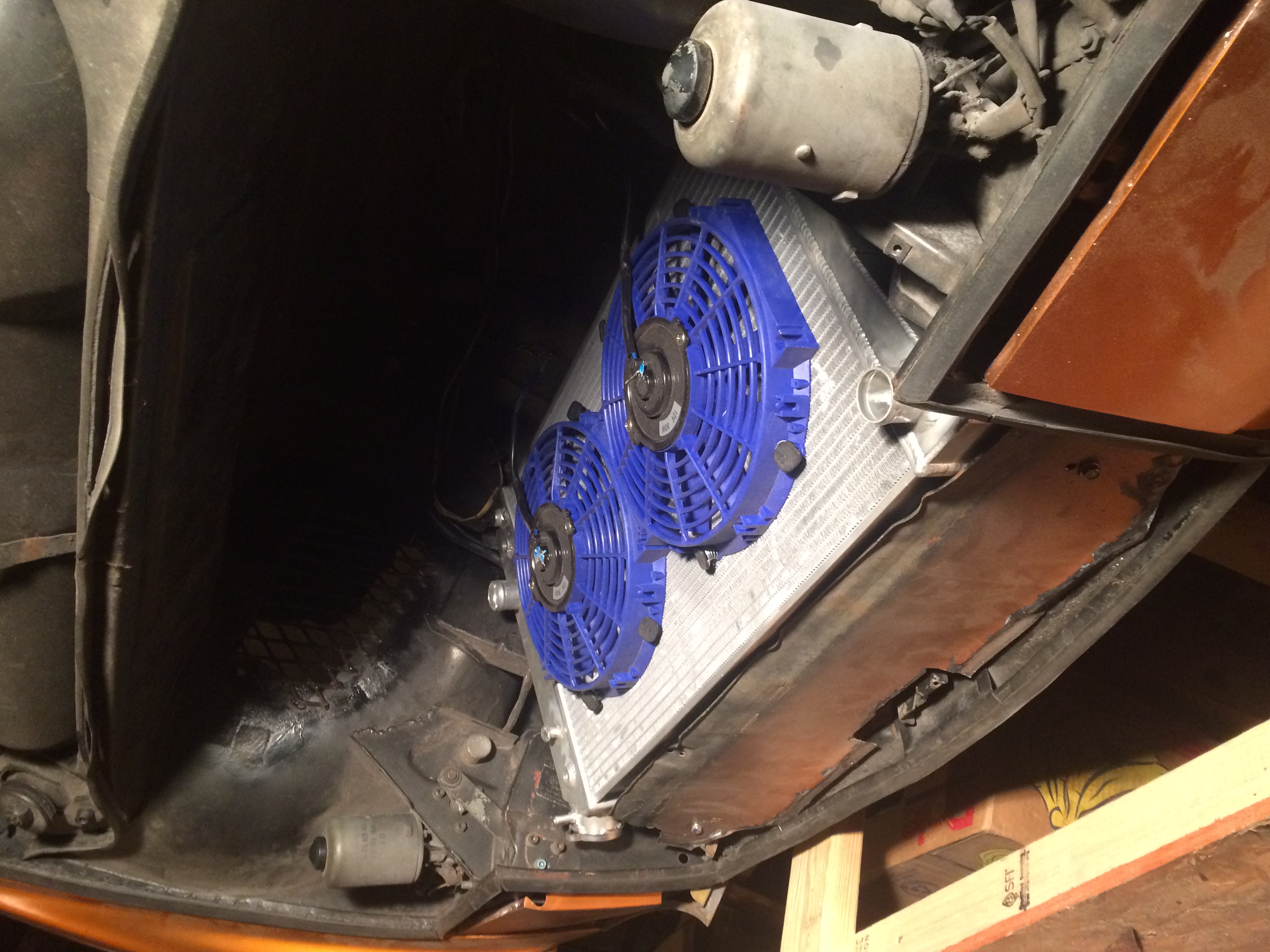

I now have my radiator shroud done for now. Later on im gonna properly paint it but im running out of time. Im trying to bring it to the pierce county skills center car show on the 21st of may. its on 160th and canyon in puyallup WA. The more teeners there the better. Id love to not be the only 914 there(considering i make it). Attached Image

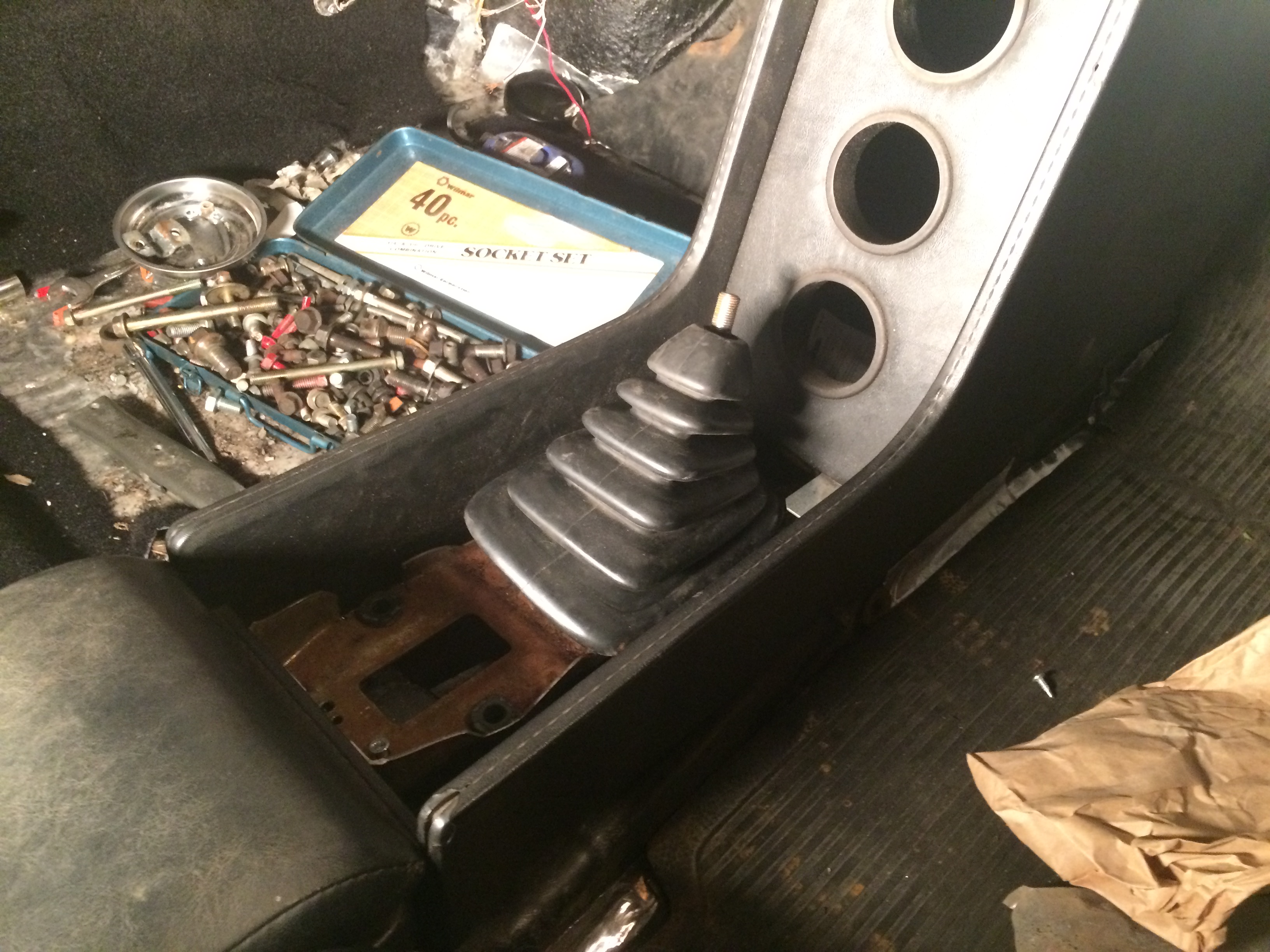

Ive also been working on the shifter. i got the cable shift kit from ian at coldwater 914 and i am trying to prove that you can use the mr2 shifter and stock center console. so far so good!Attached Image

jimkelly   I too bought the radiator with fans but no shroud ...   Apr 3 2016, 11:56 AM
tazz9924   I too bought the radiator with fans but no shroud...   Apr 6 2016, 01:05 PM

tazz9924   I now have my radiator shroud done for now. Later ...   Apr 27 2016, 11:11 AM
