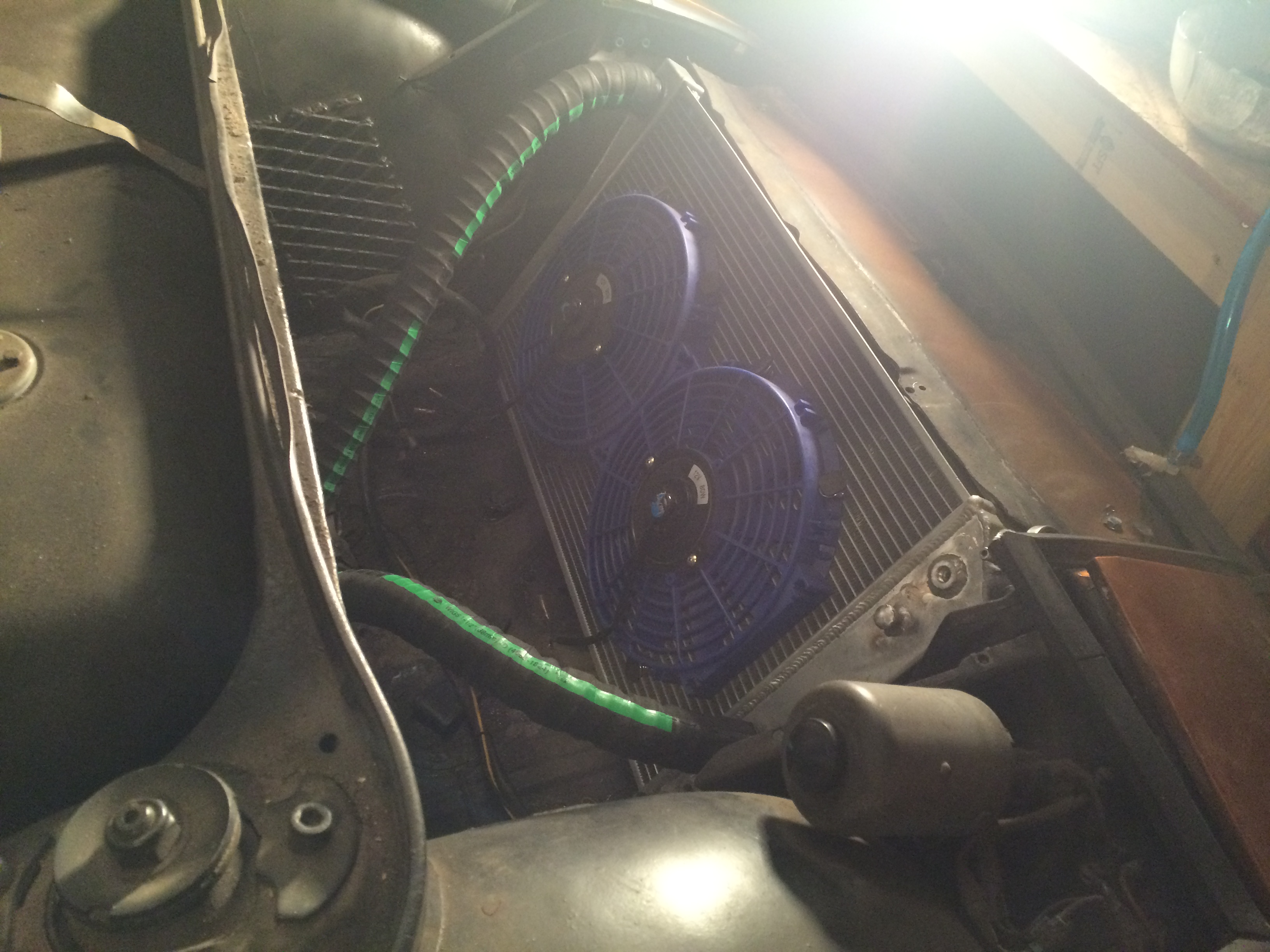

installed radiator hose last night. it was flexible 1-1/2" hose and it fit perfect through the rack and pinion. a hole was cut and now it looks like a racecar!Attached Image
