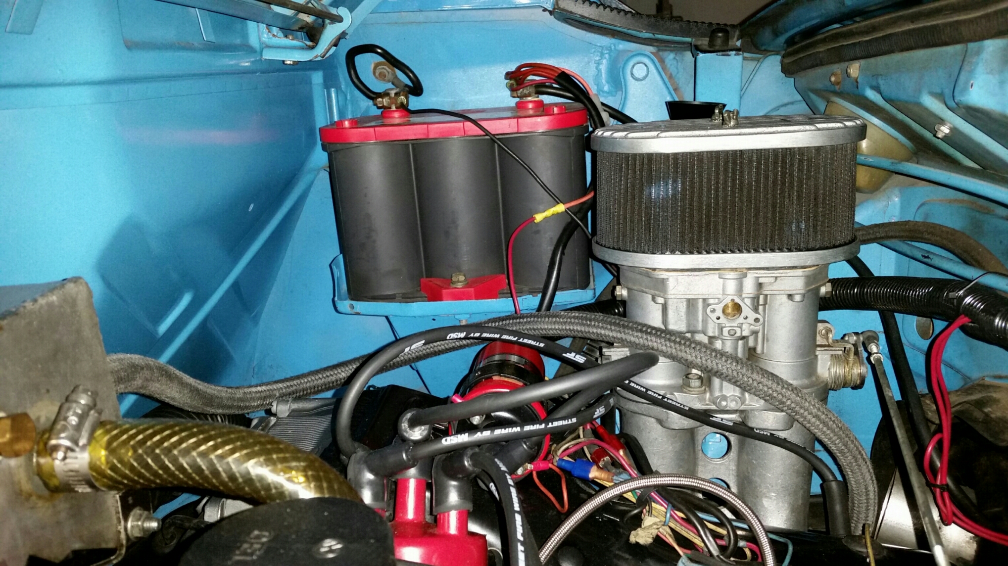

A lot of people use the Optima batteries. No worries about acid damage to the hell hole area.

QUOTE(Amphicar770 @ May 3 2016, 09:49 AM) *
IIRC I got a RED TOP R34. Worth the extra $... Amazon probably has the best price, especially if you have access to Prime. I also remember using the shipping spacer so the factory hold down clamp will hold it down. I is just a red tray the battery clips to the bottom of the battery and that moves it enough for the clamp to catch it.

If I think about it, I'll get a photo of mine this afternoon and edit this.
(IMG:style_emoticons/default/agree.gif) I got mine from amazon. Cheapest price I could find. No more worries about battery acid eating away my car!
