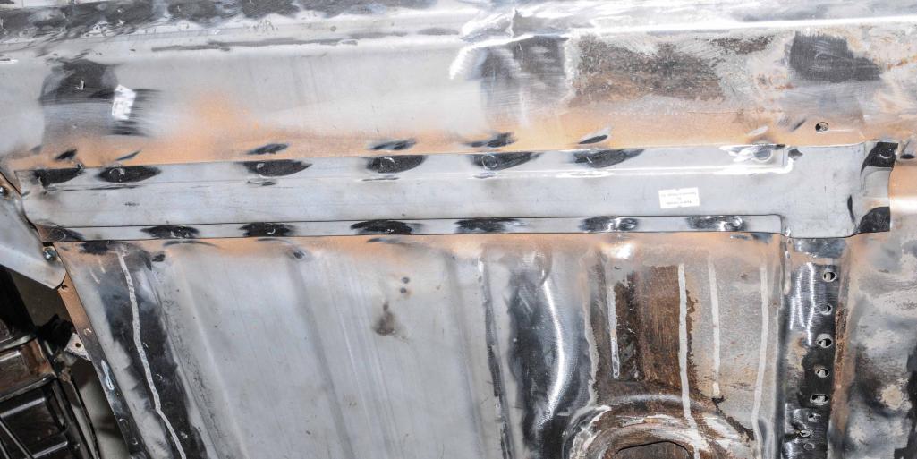

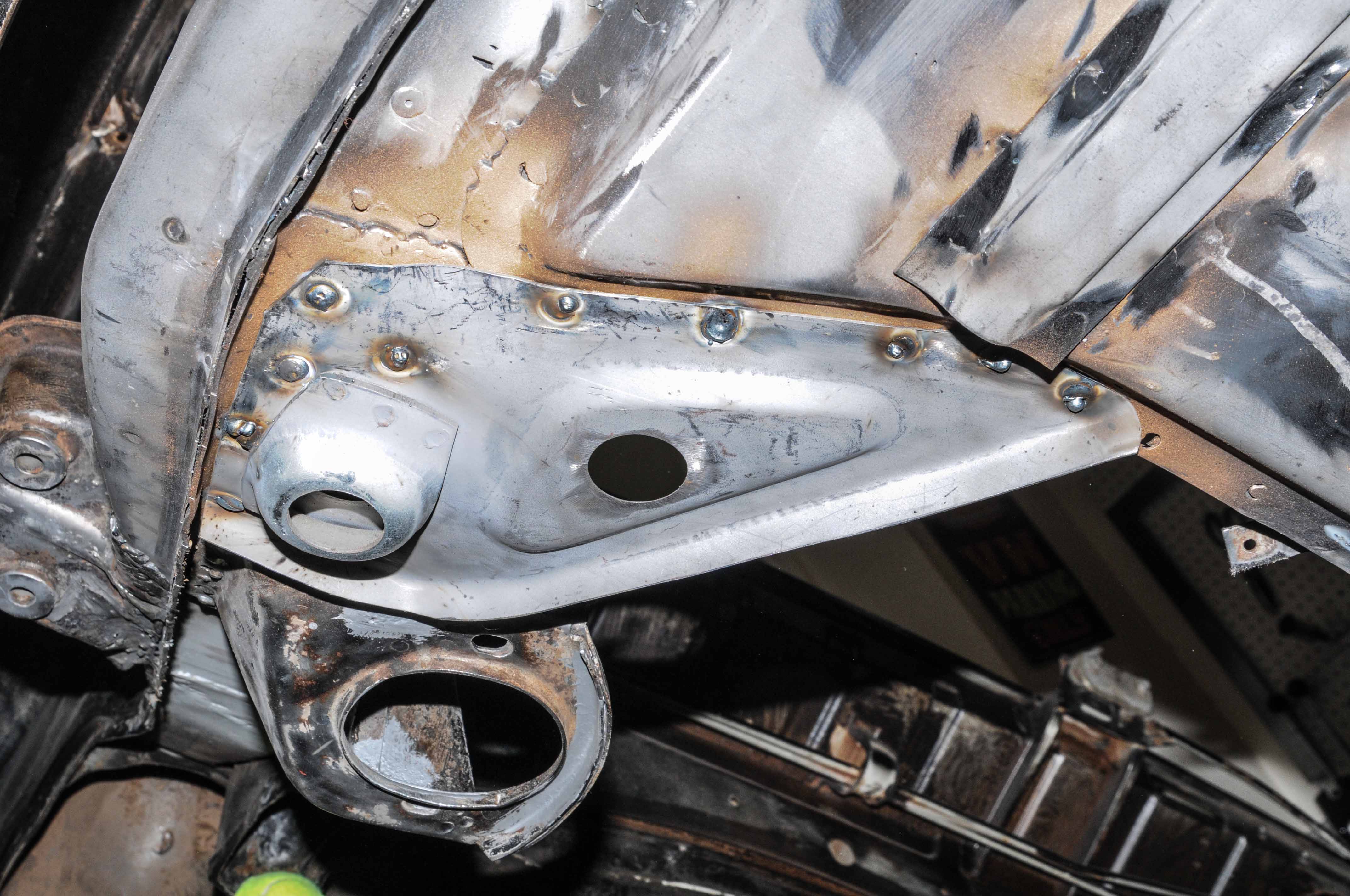

So it's been a long time... After the finger injury's infection caused a bout of pneumonia, and then the going on vacation for the entire month of April, it was really nice being home in the garage the last 2 weekends.
