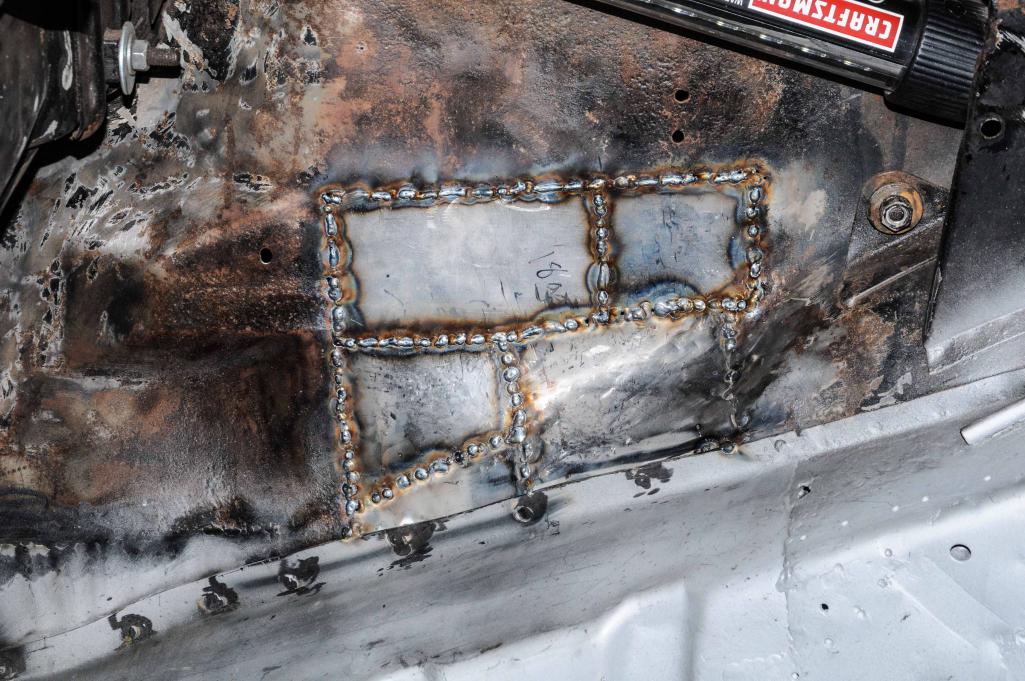

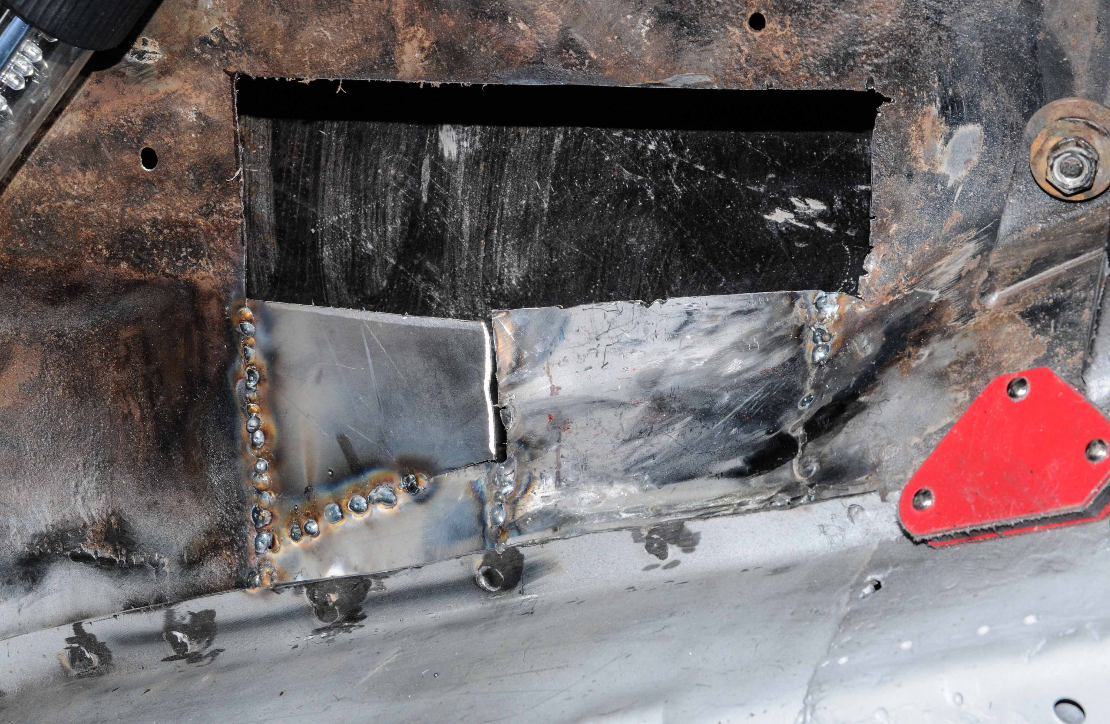

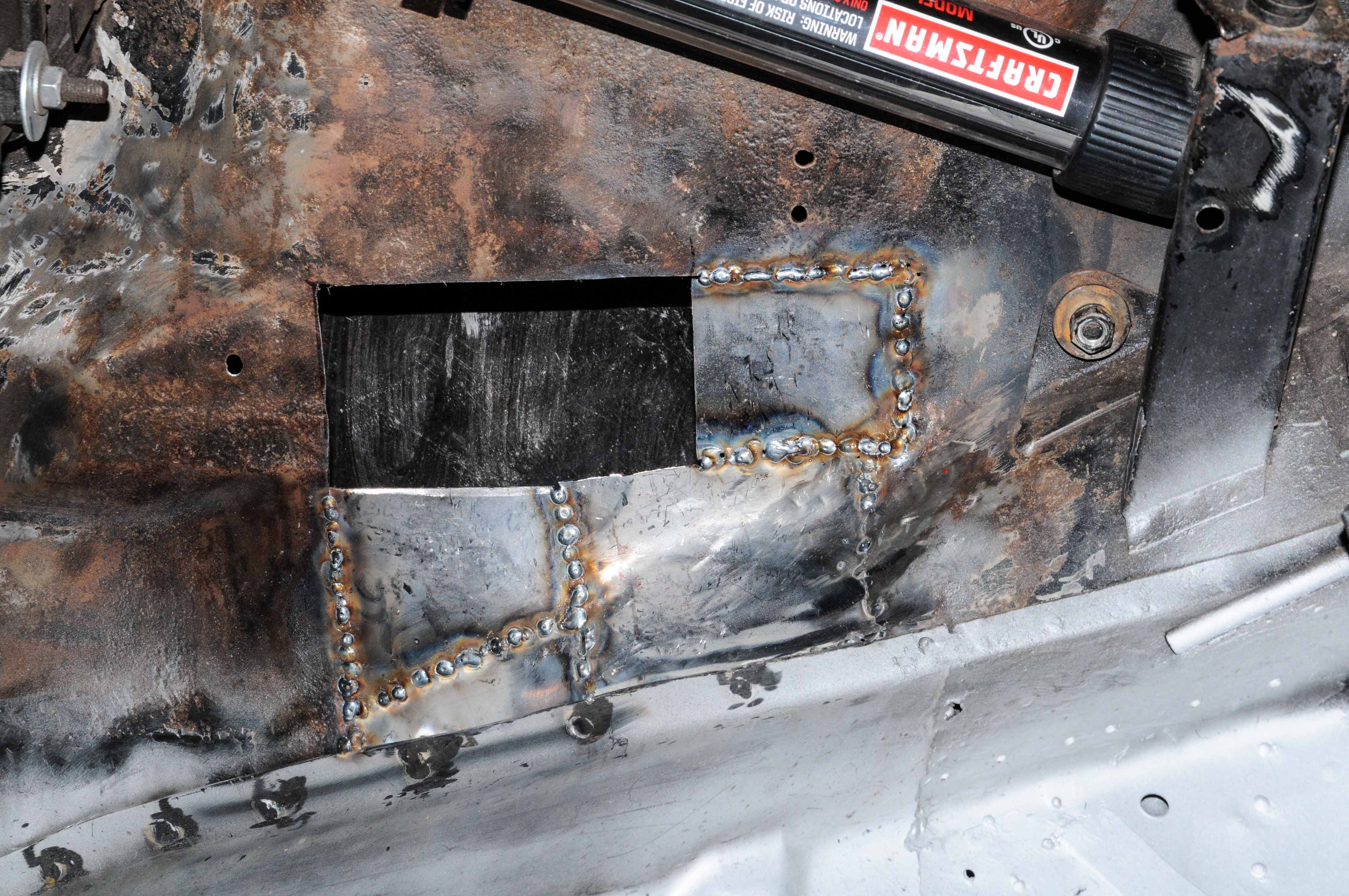

This weekend was spent on one major job, a job I thought was going to be minor. I had about a 4" x 4" hole, but when I went to weld in the piece that was part of my RD replacement panel I found that its bends and shapes didn't really fit and the surrounding metal was unweldable and I had to cut a lot more out. I salvaged some of the piece, but the rest needed to be fabbed. I'm extremely proud of the work and the technique and wish the photos could better show the compound curves accomplished. Here's how I did it: I would weld one edge of a small piece, then bang another edge to meet its mate, weld it, then bang the next, etc, one piece and one edge at a time. I used no hammers, but only dollies for the banging since they were easier to wield in the small spaces.
It was kinda funny that on Saturday I ran out of welding wire, and then today (Sunday) I ran out of gas, so I did some work organizing the garage, removing the heat shield and targa pad, and other little jobs that would eventually need done anyways... It's just funny that what I thought would be an easy, 2 hour job turned out to be a crazy, 2 day job. It still needs some finishing, but that will come later when it's time for primer prep.
