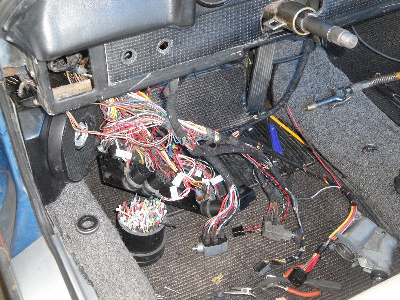

Here's where I start in the am. Wrap everything up and tuck it away.
Everything works as it was delivered from factory. Fresh air fan does need to be refurbished. Only has middle speed.
Then reinstall the knee pad and head home to prep for WCR.

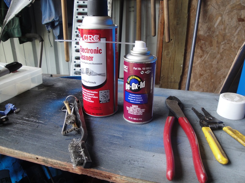

A shot of a few of my weapons.............

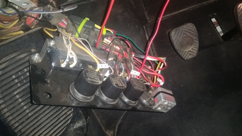

Hopefully I can get it tidied up tight and tidy like mine.
I unwrapped the wires for the flasher relay on mine. It lays behind the light switches.
That's why you don't see it here.

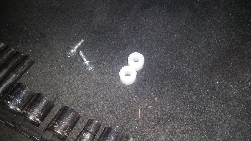

I do stand off my fuse panel just a smidgen. I use these thick fiber washers.
