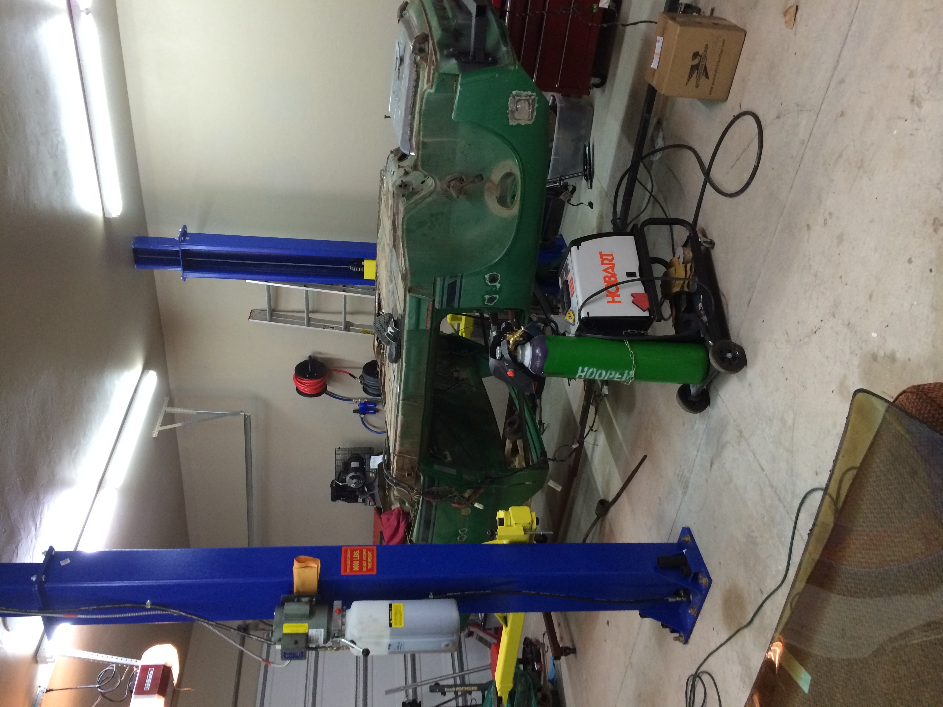

Past few months have been busy moving, setting up my new workshop, running the Houston Marathon, and finally getting back to work on the 914.
I was lucky enough to buy a nearly new house with a 9000lb two post lift in the second garage. Here the car is upside down on the rotisserie, working on the front trunk floor

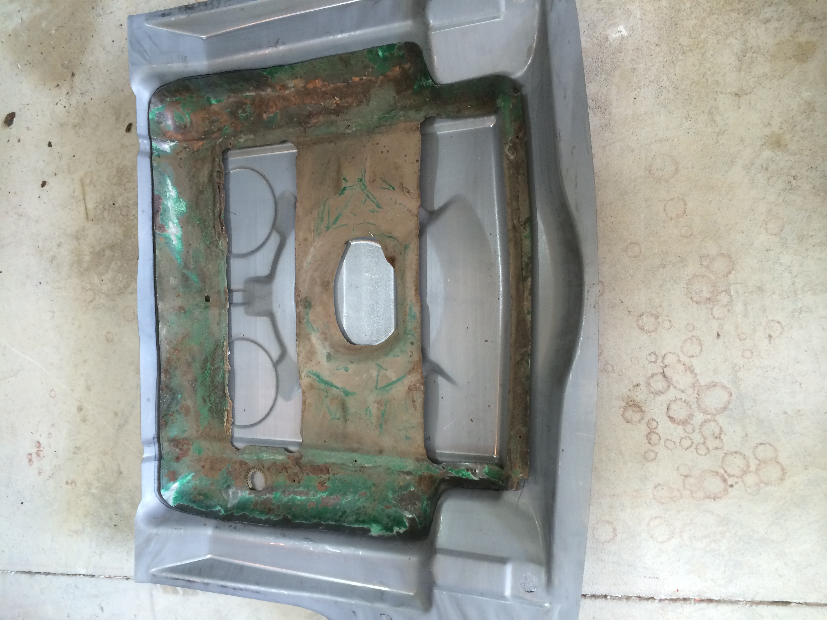

jmitro   New front trunk floorpan welded in place   May 18 2016, 12:46 PM
