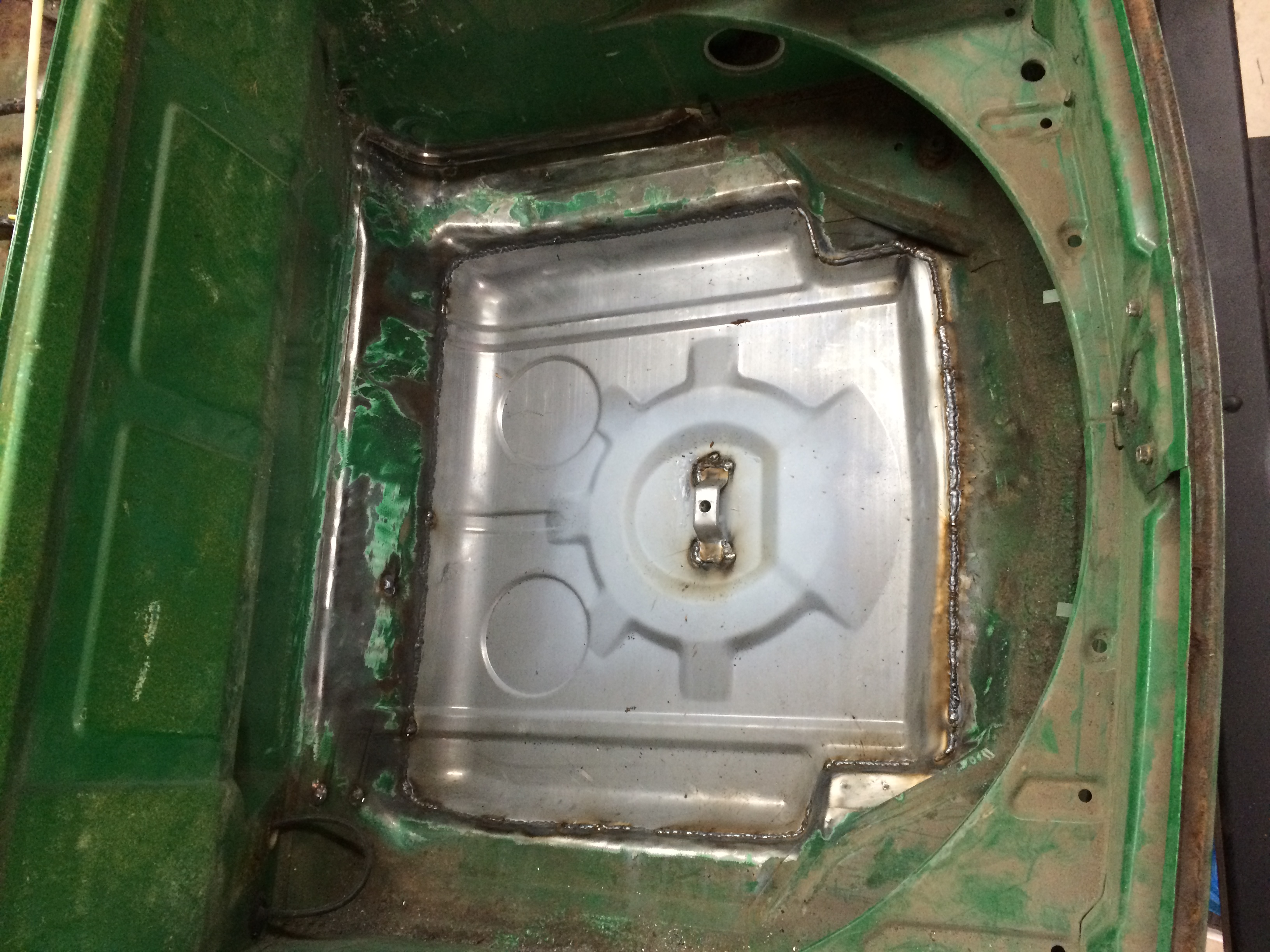

jmitro   Past few months have been busy moving, setting up ...   May 18 2016, 12:38 PM
jmitro   New front trunk floorpan welded in place   May 18 2016, 12:46 PM
