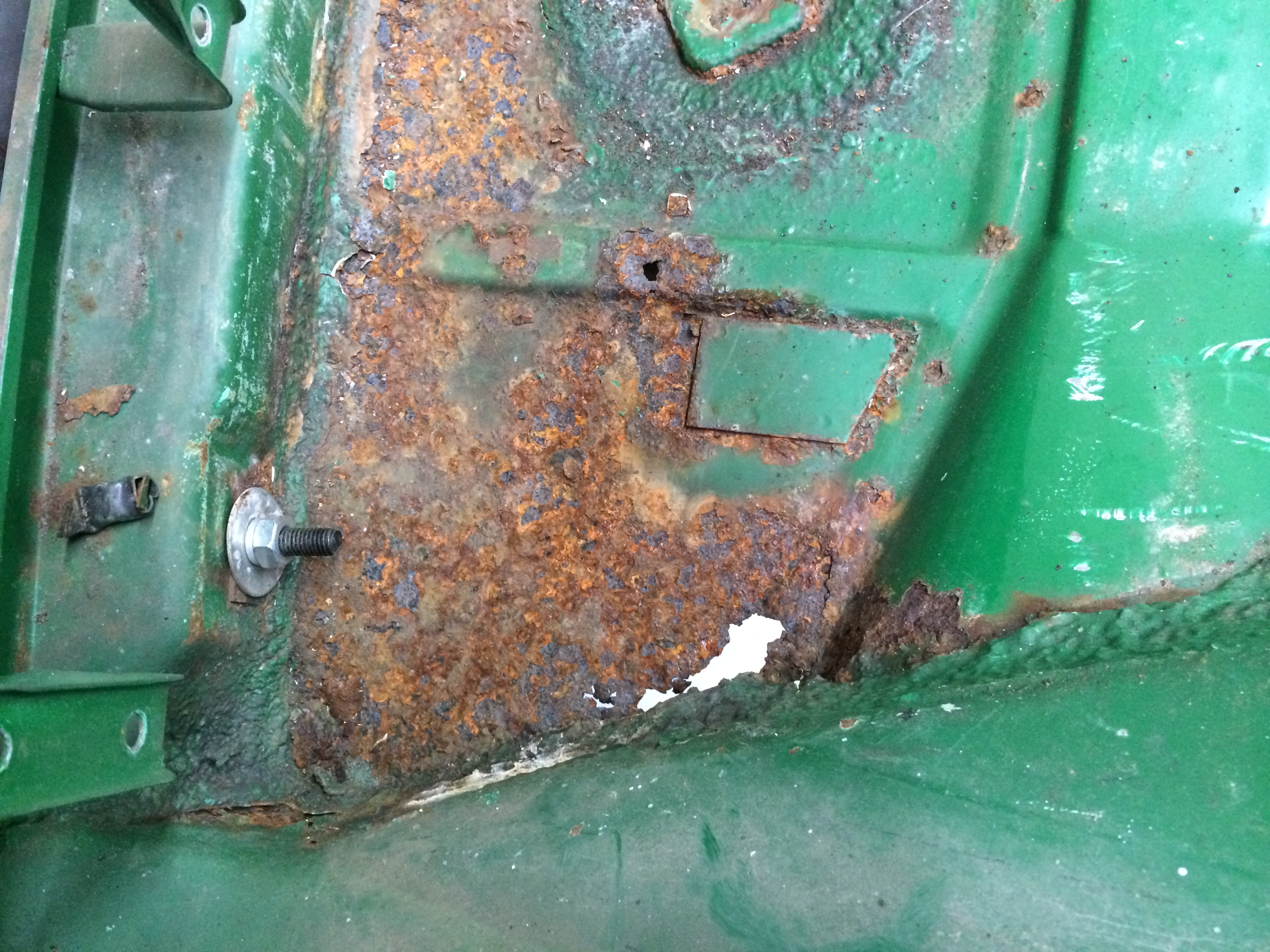

jmitro   Floor pans looking pretty crusty, especially passe...   Sep 17 2015, 10:40 AM

jmitro   Past few months have been busy moving, setting up ...   May 18 2016, 12:38 PM
jmitro   New front trunk floorpan welded in place   May 18 2016, 12:46 PM
jmitro   Started repairing the rusted out right front Apill...   May 18 2016, 12:50 PM
jmitro   started working on the rear trunk floorpan:   May 18 2016, 12:52 PM
jmitro   RE: newbie 74 1.8 project   May 18 2016, 12:54 PM
jmitro   Cutting the entire section out while leaving the g...   May 18 2016, 12:57 PM
jmitro   surfaces cleaned down to bare metal in preparation...   May 18 2016, 01:00 PM
jmitro   Here is where I stand now: about to weld in the t...   May 18 2016, 01:03 PM
