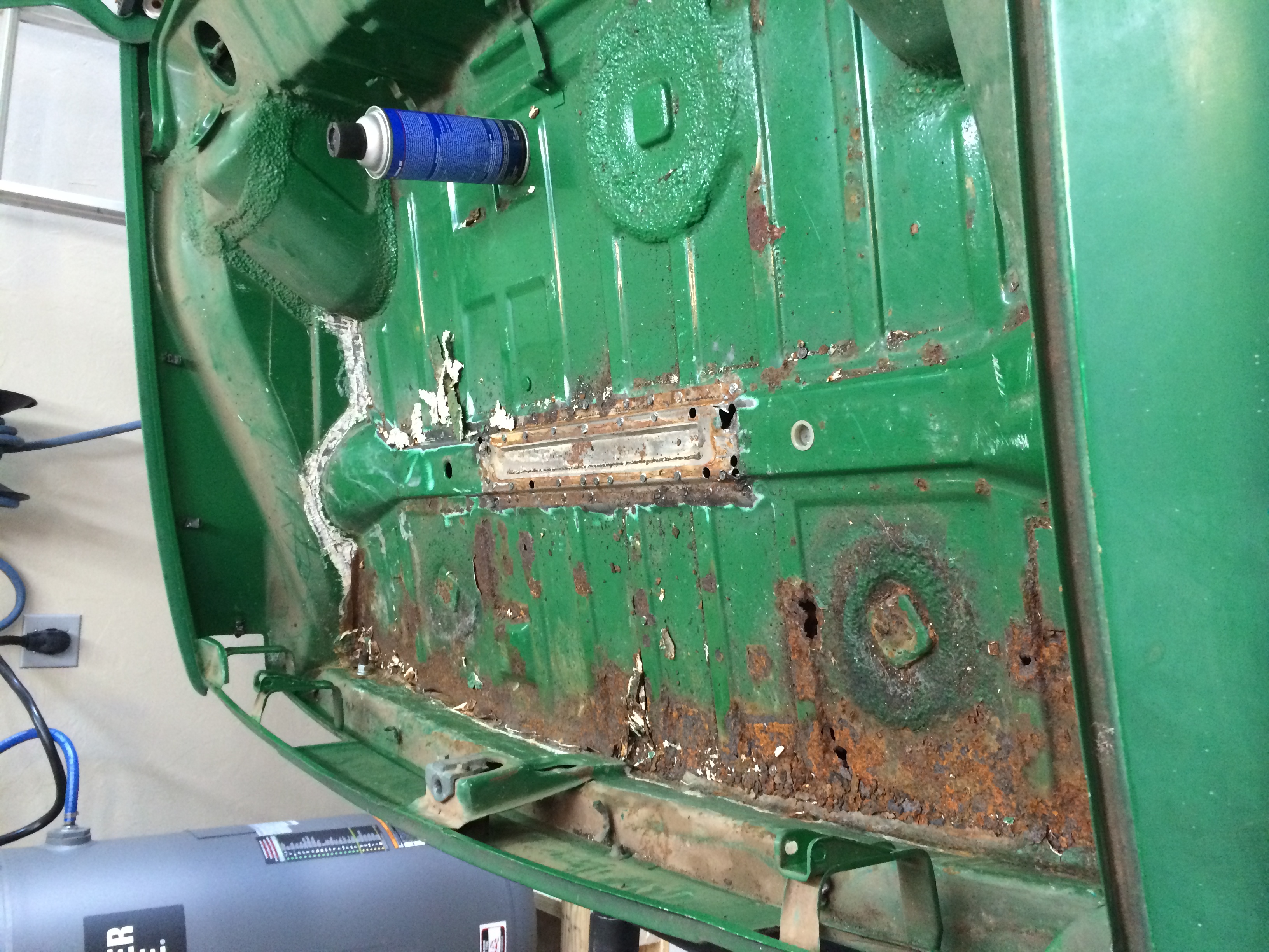

jmitro   Well the car has become a full restoration of sort...   Sep 17 2015, 10:37 AM
jmitro   Floor pans looking pretty crusty, especially passe...   Sep 17 2015, 10:40 AM
