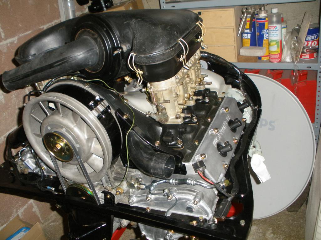

914Gelb   engine   May 19 2016, 12:16 AM

sixnotfour   looks like a pretty decent six, other than needing...   May 19 2016, 05:54 AM
Luke M   looks like a pretty decent six, other than needin...   May 19 2016, 04:41 PM
914Gelb   [quote name='sixnotfour' post='2347054' date='May...   May 20 2016, 12:13 AM
914Gelb   Yes it was yellow, and after restoration it will b...   May 19 2016, 06:19 AM
