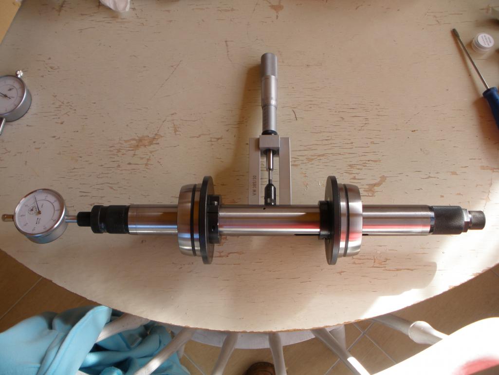

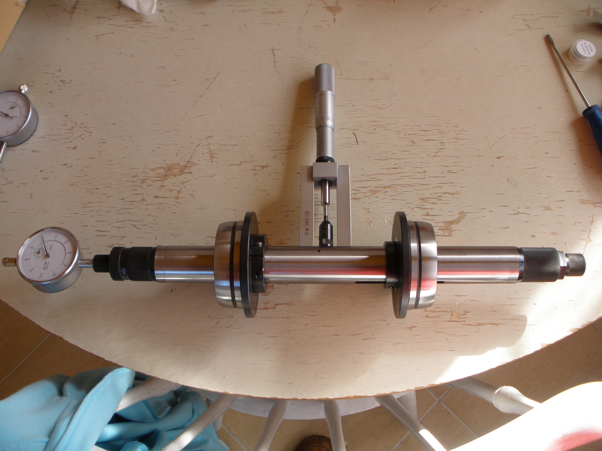

transmission, rebuild by my own, bought tools to align shaft and pinion (was damaged)

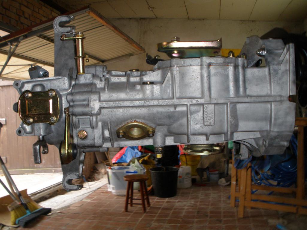

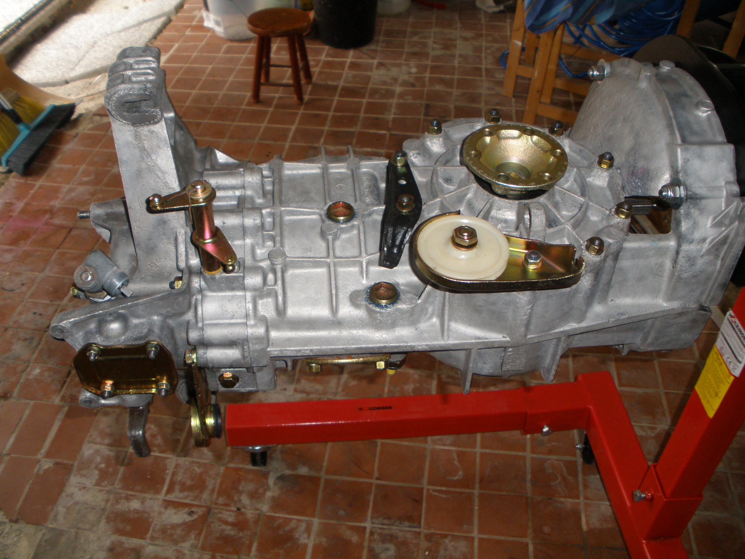

914Gelb   transmission, rebuild by my own, bought tools to a...   May 19 2016, 12:20 AM
914Gelb   pinion   May 19 2016, 12:26 AM
