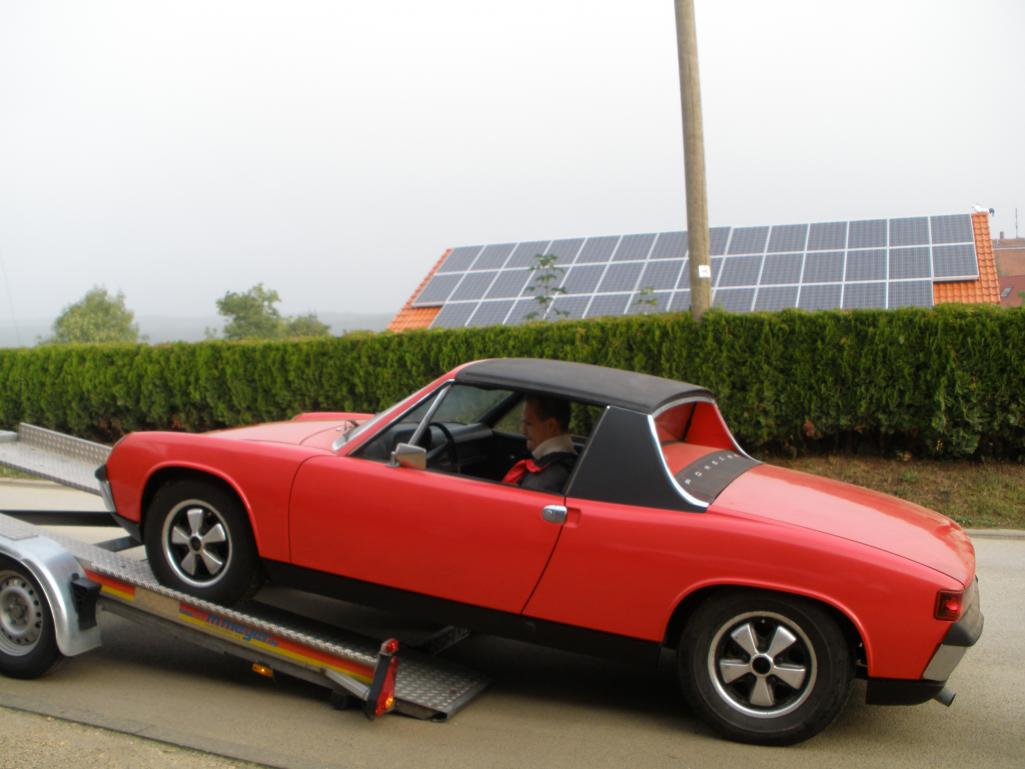

Before the rebuild, I'm sitting in the 914-6

914Gelb   Before the rebuild, I'm sitting in the 914-6   May 19 2016, 12:36 AM
