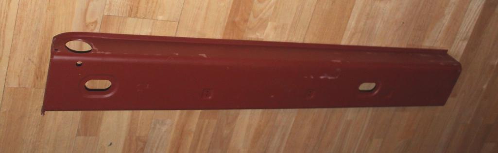

looks like a pretty decent six, other than needing a hip replacement....was it yellow then green now red ???
the inner long, in Germany looks to be perfect compared to the RD one..the bottom flange even has the correct stamped impressions...here is a link;
http://www.ebay.de/itm/Innenschweller-rech...S-/251409572397
