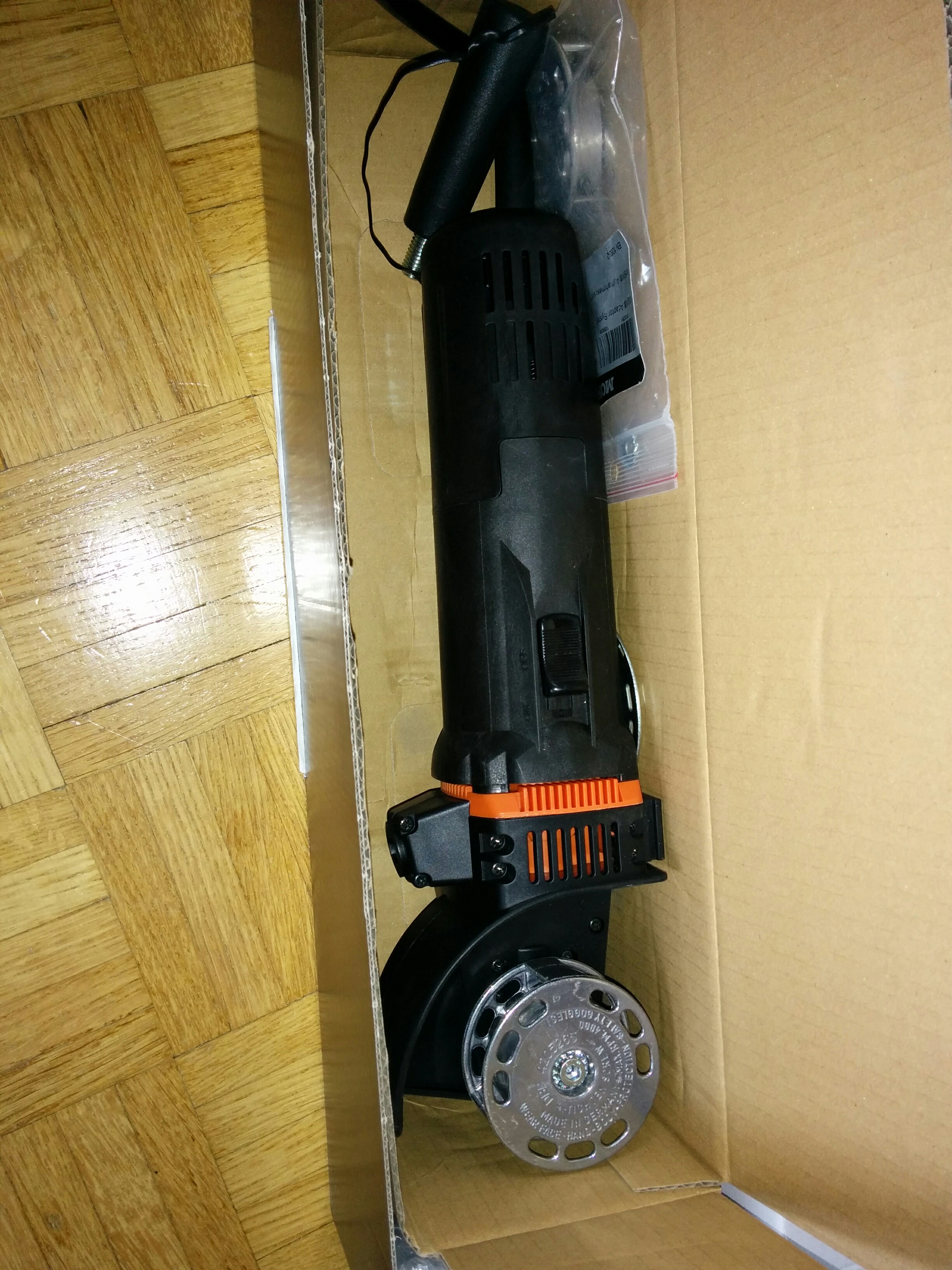

For the undercoating and Paint removal I decided to use mbx. Hoppefully it works as promised (IMG:style_emoticons/default/sawzall-smiley.gif)

914Gelb   For the undercoating and Paint removal I decided t...   May 19 2016, 08:56 AM
worn   Nice tool but it is still a dirty long process....   May 24 2016, 10:22 AM
914Gelb   Nice tool but it is still a dirty long process...   May 25 2016, 02:53 AM
