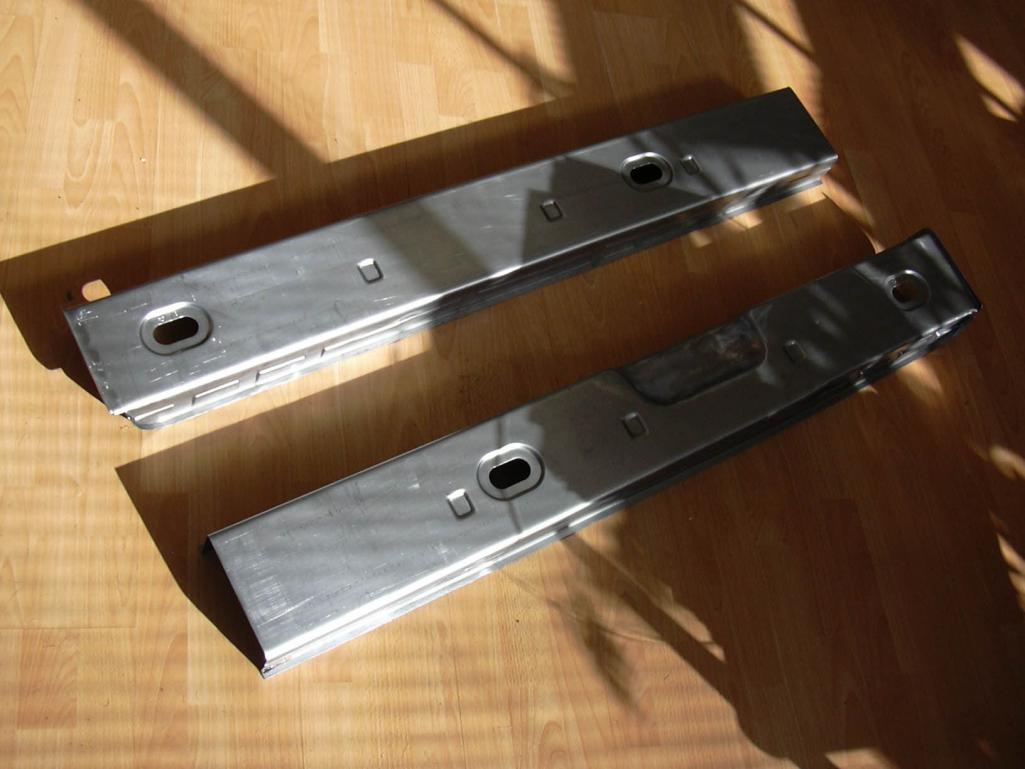

rick 918-S   Wow! Those parts are Awesome!   May 20 2016, 07:01 AM
