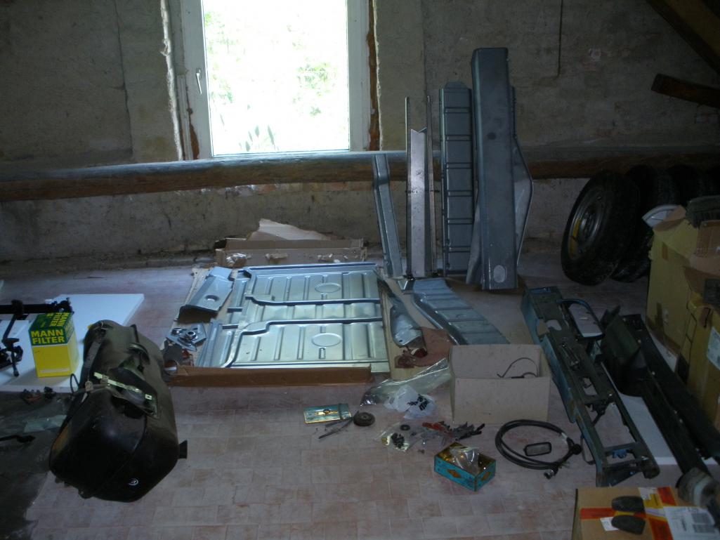

since many years I'm working on my 914-6 restoration project. Now I have finished most of the jobs like engine and transmission rebuild, electric harness, suspension ..., now it's time for the body work. Normally before I start I try to collect es much information to get a perfect result.
My body was repaired in the past by unexperienced (IMG:style_emoticons/default/welder.gif) and now I have to fix this badly bodywork. See the pictures and look at the door clearence than you understand.
The question is how can I fix this and if you had the same topic how was it fixed by you.

We need Pete to get a shipment from Mittlemotor so we don't have to pay that shipping per piece. Those are the parts I would use for a 914-6. Maybe cost prohibitive for the 4's but with prices rising... maybe not.
These Parts are on the market since 2..3 years, the price was much higher, as far as I remeber about 1200Euro per pice. Now it is okay at least for 914-6 restoration. I will sell the pice from RD and will order from Mittelmotor.
If you order in Germany you must also pay additional fees( custome) ore how is this in US?
The sheet metall I already have for my car and my 2nd 914-4 2.0
