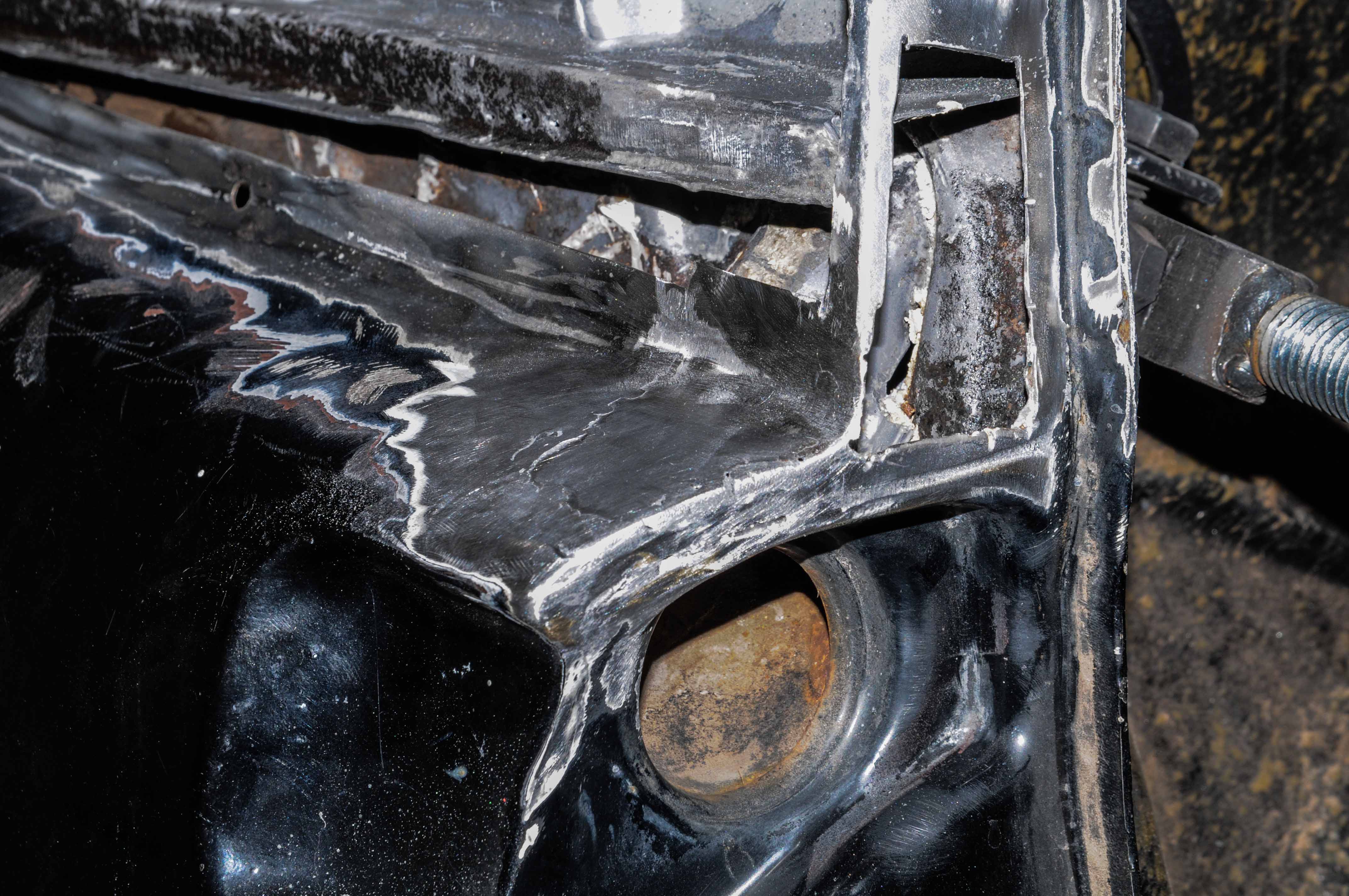

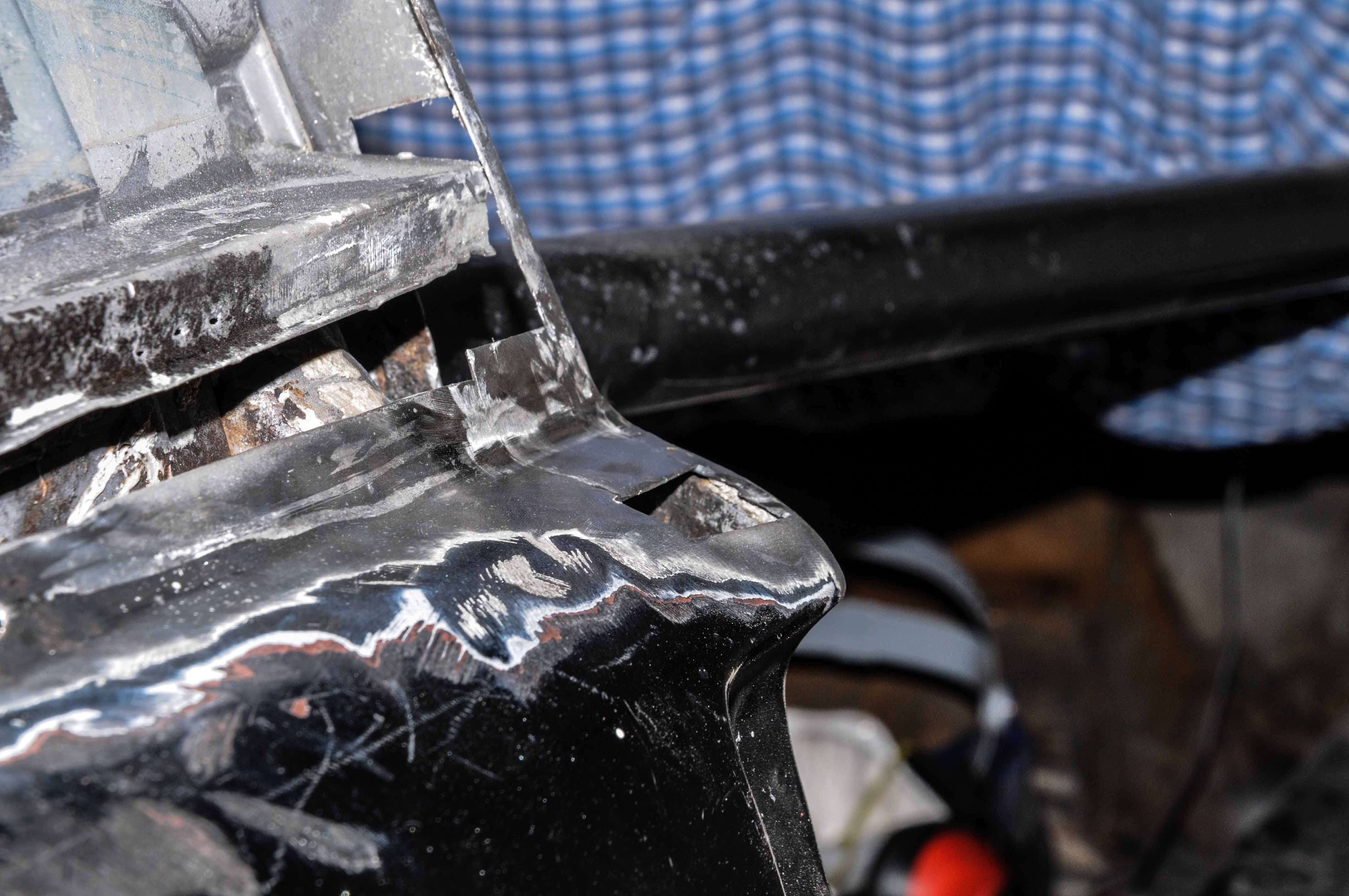

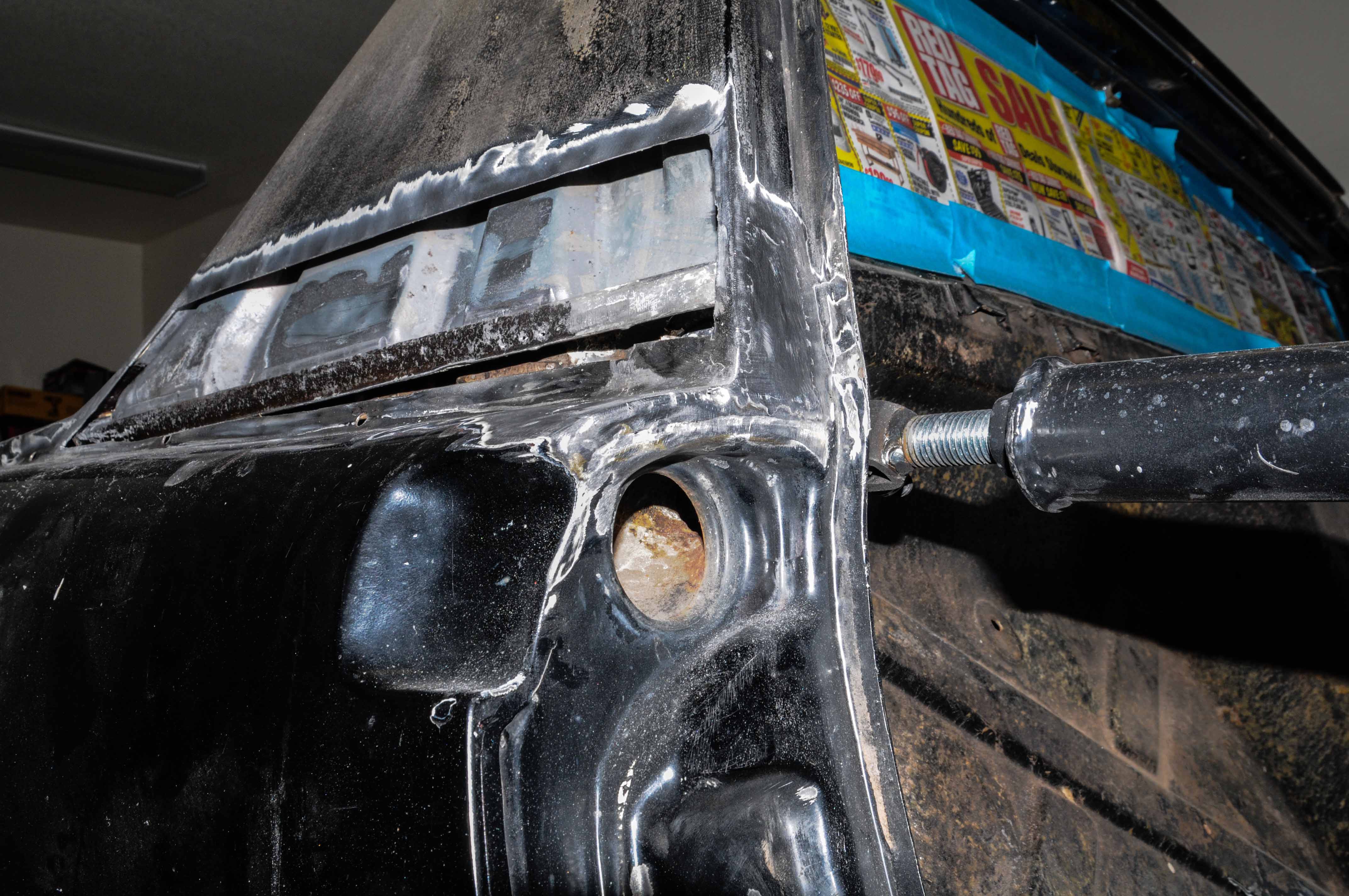

DirtyCossack   What you see is 6 hours of work. This was probably...   May 22 2016, 08:52 PM
DirtyCossack   You can also see in the pics (not really this one)...   May 22 2016, 08:57 PM
