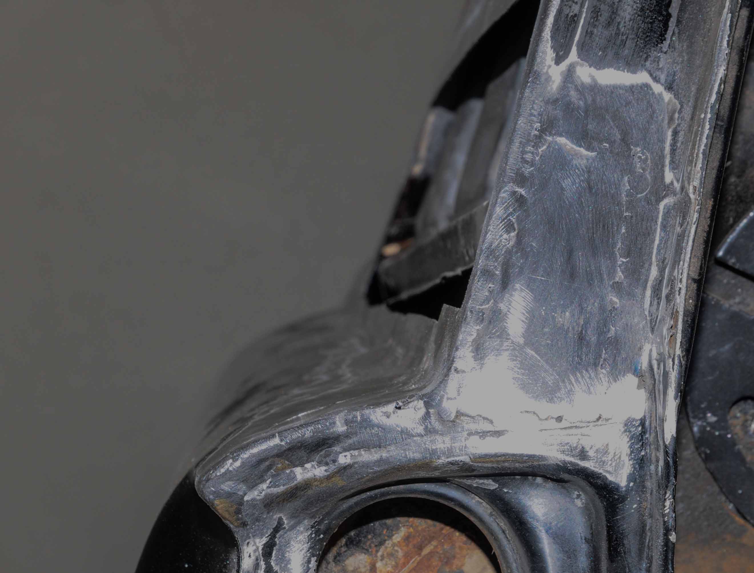

You can also see in the pics (not really this one) that this fender has had a respray. I've found some evidence of a wreck on the right front corner, but not the rear outside of a ding or two, I guess they just sprayed this whole side, because the driver side is still original paint...
But here's another look at that edge.

2mAn   man, that thing is collecting a lot of rust.... an...   May 22 2016, 12:08 AM
DirtyCossack   What you see is 6 hours of work. This was probably...   May 22 2016, 08:52 PM
DirtyCossack   You can also see in the pics (not really this one)...   May 22 2016, 08:57 PM
