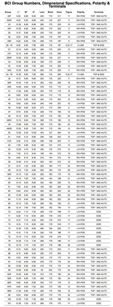

Any Ideas as what is the best battery for a 1971 914-4?
Thanks,914
dlkawashima
post May 23 2016, 04:32 AM
Posts: 9,749
Joined: 1-October 10
From: San Jose
Member No.: 12,234

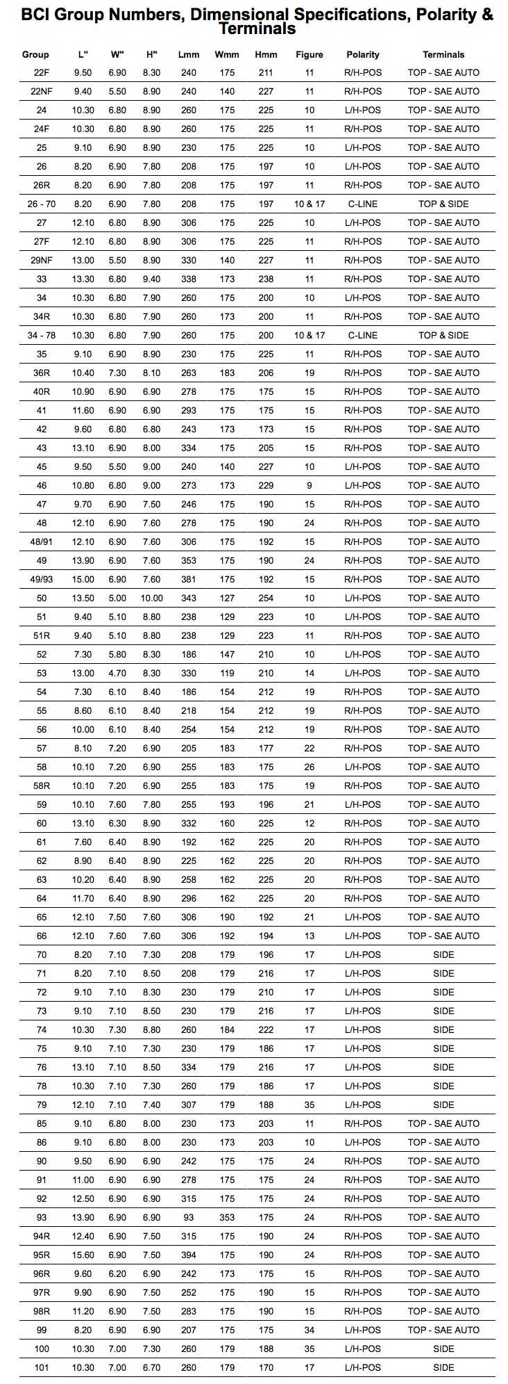

The battery purchased by the original poster is a 96R. You can look up group 96R on the chart below (click image to supersize). Group 42 and group 34 batteries also fit the stock tray.
