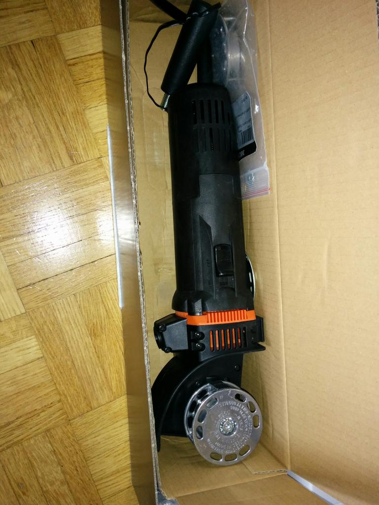

For the undercoating and Paint removal I decided to use mbx. Hoppefully it works as promised (IMG:style_emoticons/default/sawzall-smiley.gif)

QUOTE(914Gelb @ May 19 2016, 06:56 AM) *
Nice tool but it is still a dirty long process.
Not sure that you know who you are getting advice from, but Rick is the real thing. He has helped many people straighten out things that looked impossible. I suggest following his advice as he has done this for a living. Some people like puzzles formed in metal and Rick is one of them. He can reverse an origami to flat rice paper.

QUOTE(worn @ May 24 2016, 10:22 AM) *
Hello Worn,
The tool was the best choise, I chemical treatment ,sand/soda blasting is very expensive in Austria, also I have my doubst that the used medium can be removed out of all hollows.
