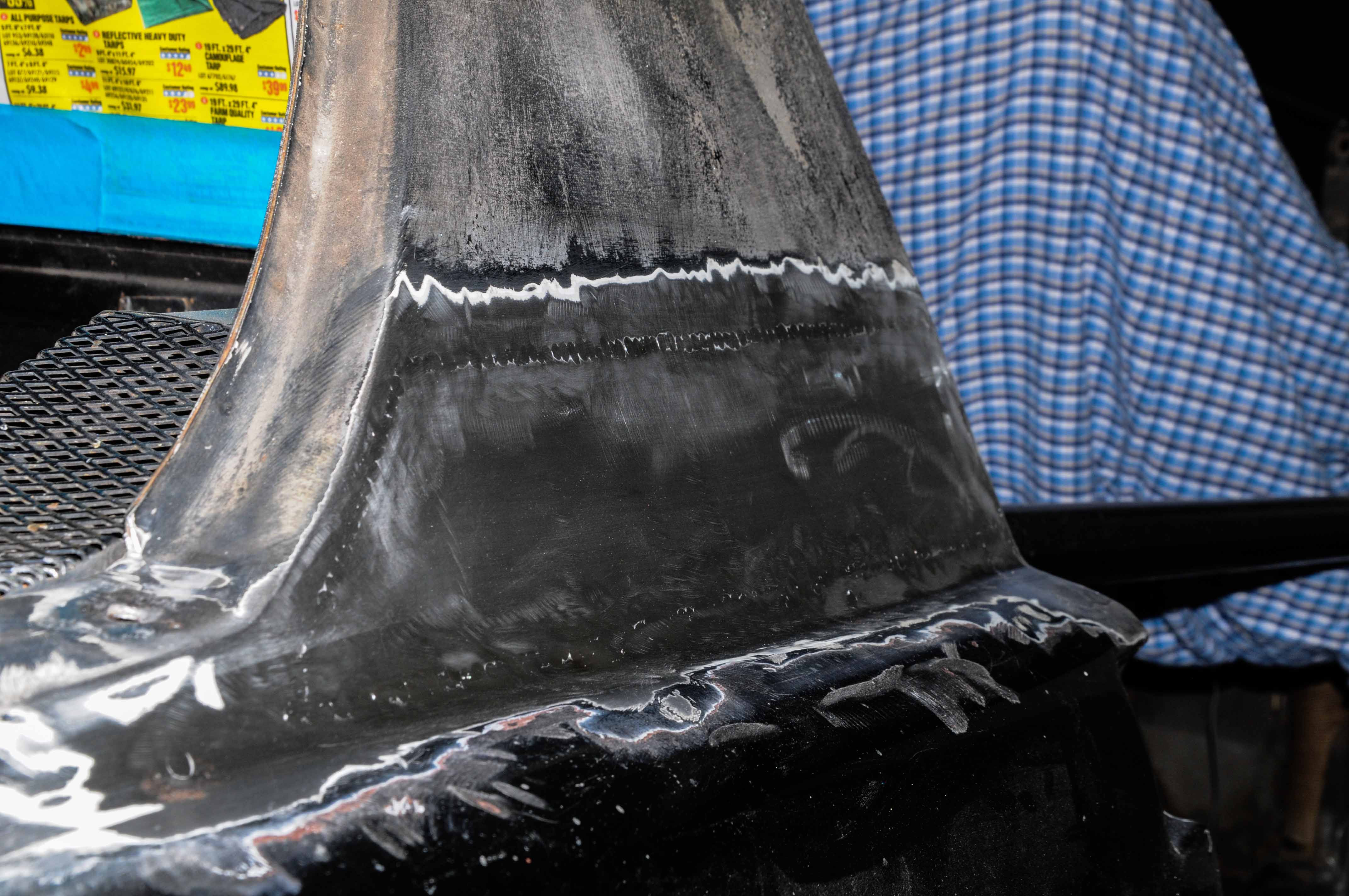

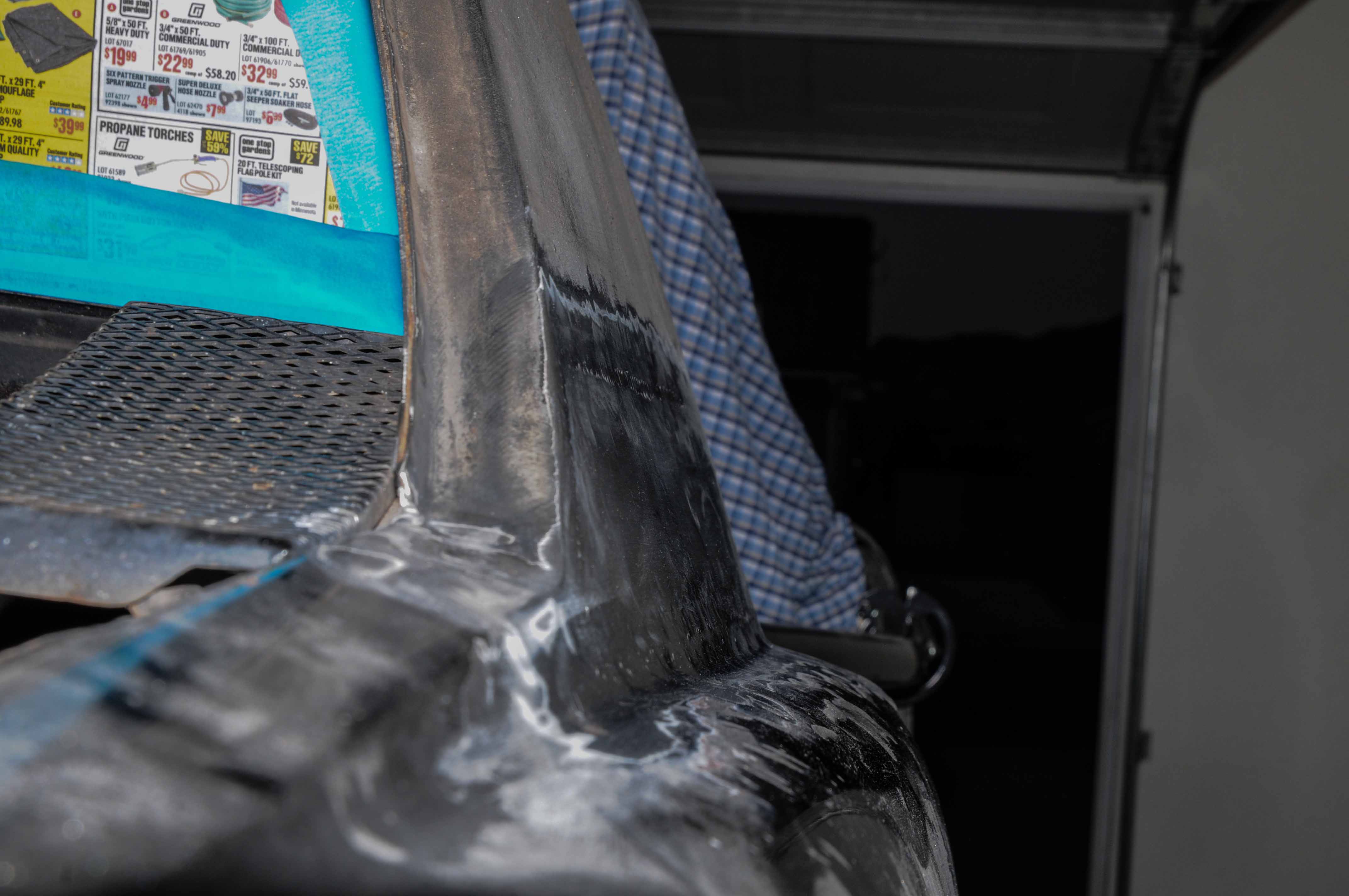

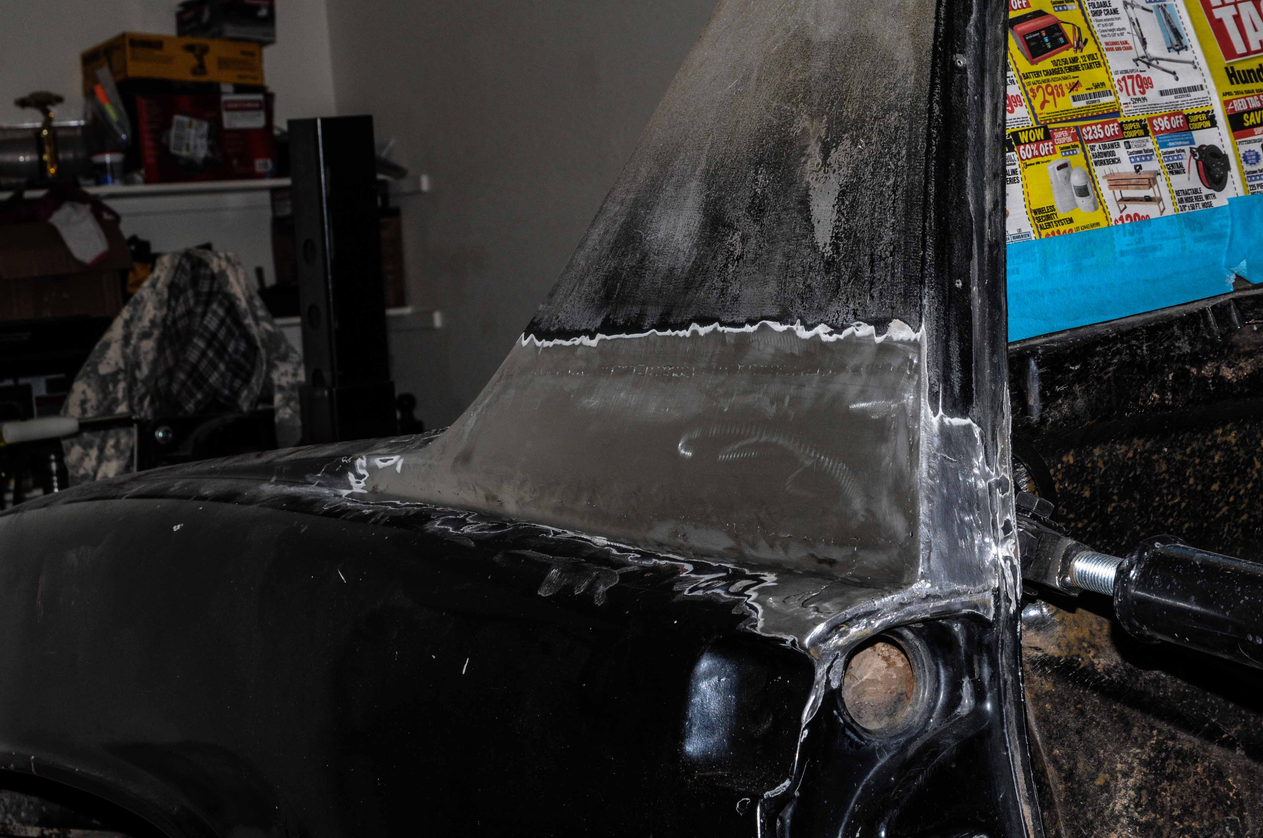

The day's plan was to get a bunch done in the garage on my day off, but as I was taking the garbage to the street I happened to notice an odd, white spot on my DD Honda Fit's tire. Of course it was a nail. I had been planning on replacing the tires towards the end of summer anyways, hoping to milk a thousand more miles out of them; the previous owner didn't drive the car much so they had minor dry rot along with wear. The funny part is that twice over the last 2 weeks the tire went a little low but on inspection I saw nothing (could it really be possible that the nail was down both times I inspected?). Anyways, I spent quite a bit of the day dealing with this. NOTE: If you buy a Honda Fit for its incredible affordability and such, get the basic model and not the "sport," the sport's 16" wheels have a weird 185 55 tire that cost me $100+ more to replace and the ride is a little louder and worse.
But the time I did spend in the shop was spent welding up the sail panel. The piece was a little tricky in that it has a minor curvature that I think I managed to get right, but I was worried about warpage on such a broad, flattish sheet so I welded really slowly. I'm not sure if it was a heat warp or what, but the top welded edge did manage to sink and there's a bit of a low spot I think filler will fix without violating my 1/8ths inch rule (filler will be no thicker than 1/8th inch). I tried to show the low spot in the pics, but it's hard to see; though you can see the low spot on the fender top. I guess it's also worth mentioning that I filled in the little trim holes and reworked (welded a fat line and grinded) that jamb edge too. Overall it was a good day in the garage.
