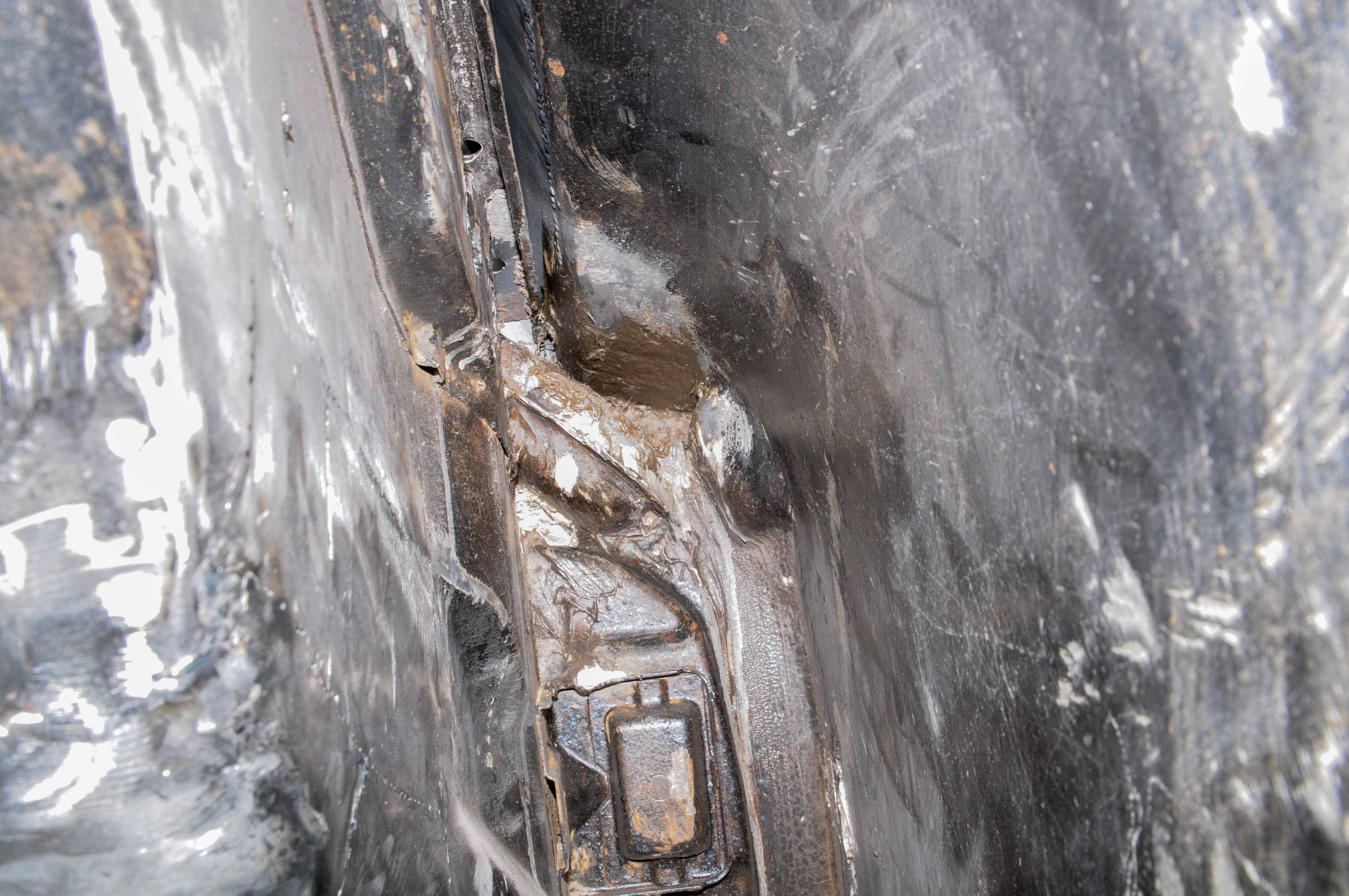

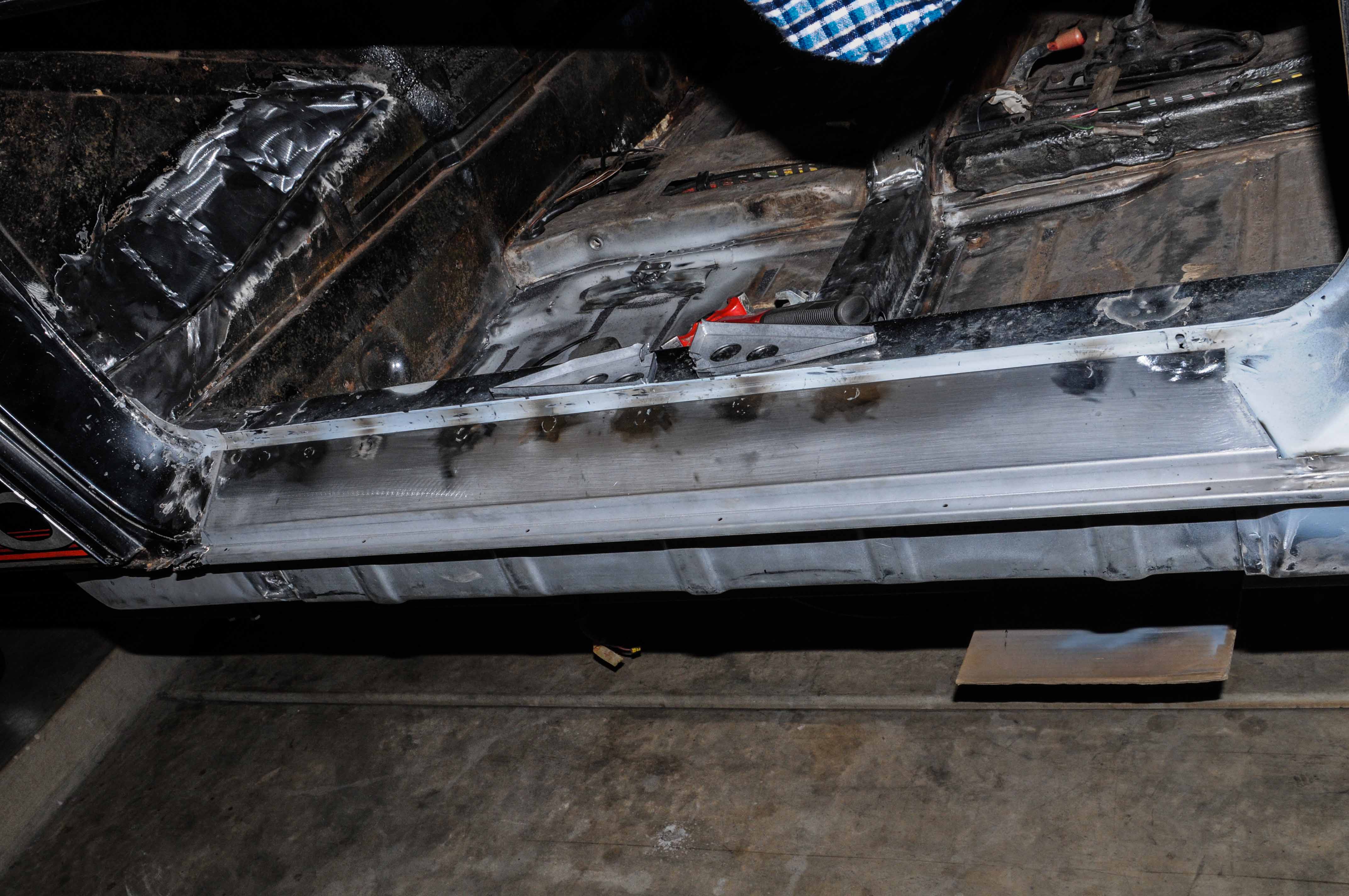

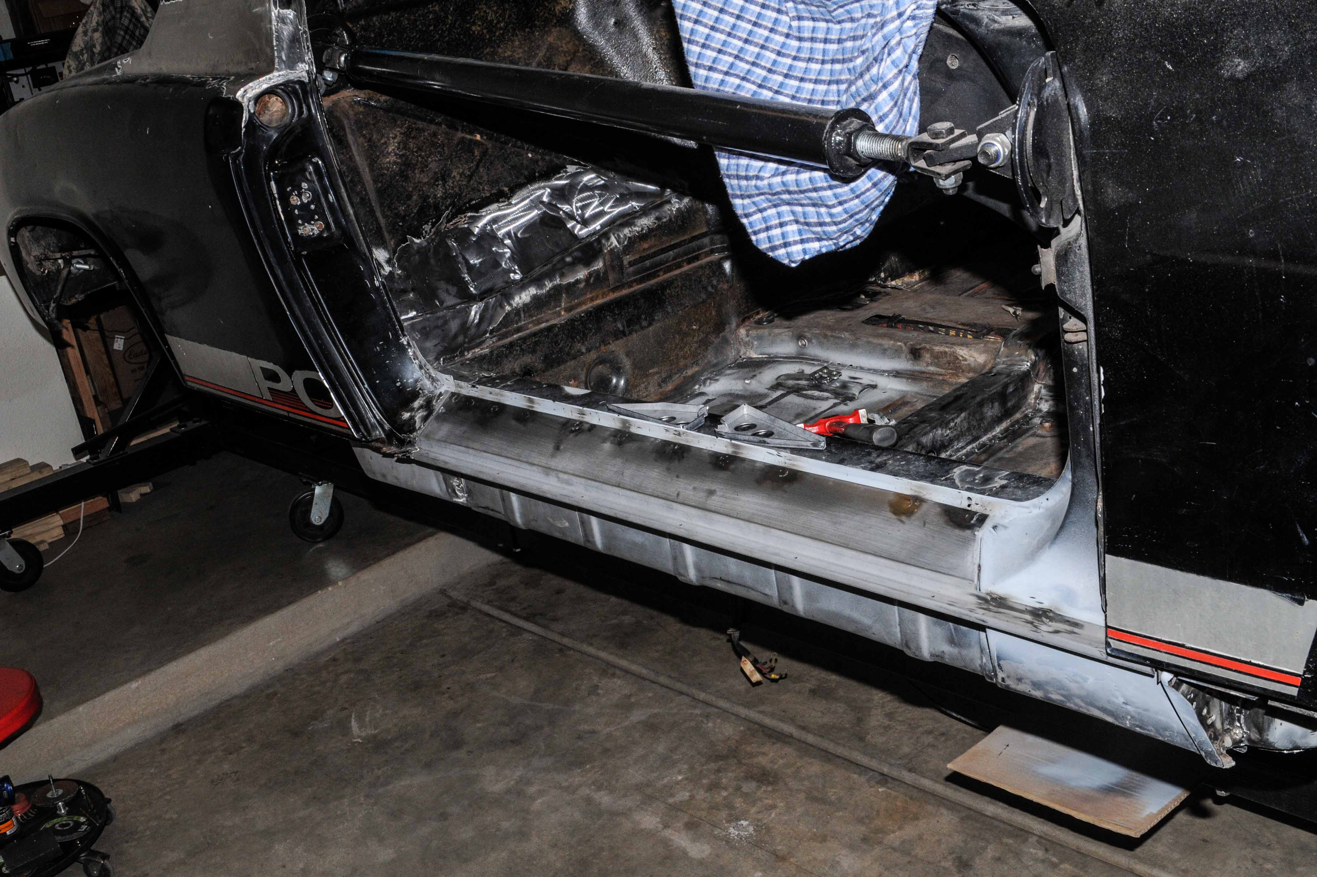

Post for Saturday 28 May:
Shop soundtrack: my Willie Nelson Pandora station:
Another shorter day in the shop... My plastic lawn chair kinda broke so I spent some time trying to fix it with fiberglass filler stuff, didn't really work. But it did give me the idea to use that to reinforce and back the little patches at the top of the door jamb now instead of later. It kinda sucked getting up in there, but the fact that it squeezed out a few pinholes was a good sign.
I then moved on to the door sill in an obvious attempt to avoid that suspension console. The door sill fit really well and went on easily, but as I went to install the little triangles and grind the welds I noticed that I screwed up and the thing wasn't straight. It was kinda weird drilling out my own welds... but I managed to get them broken with the help of a little hacksaw underneath. The sill then went on straight and easy without damage and the triangles fit perfectly. NOTE: IF you're asking my opinion, or if I were to weld another sill on, I would either figure a way to do it with the triangles pre-welded, or at least use them as a guide (as I did the 2nd time) to keep the gap straight and what not. After the error I was paranoid, so I checked and double checked this thing at least 50 times. Overall it was a good day in the garage, and great that I got away with an error without permanent damage/costing $$$.
