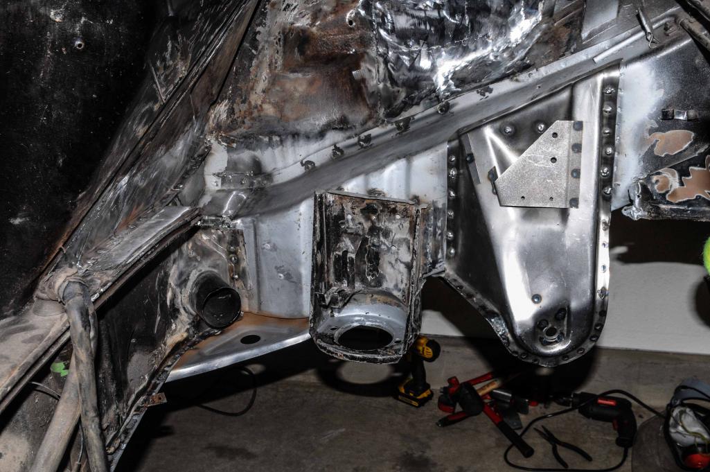

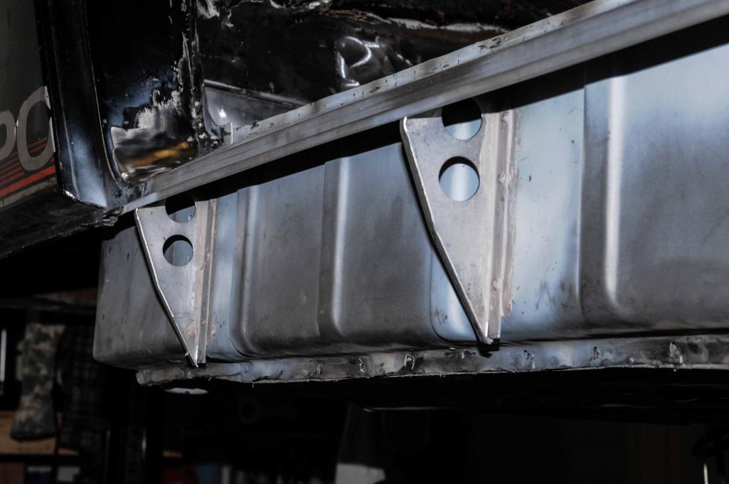

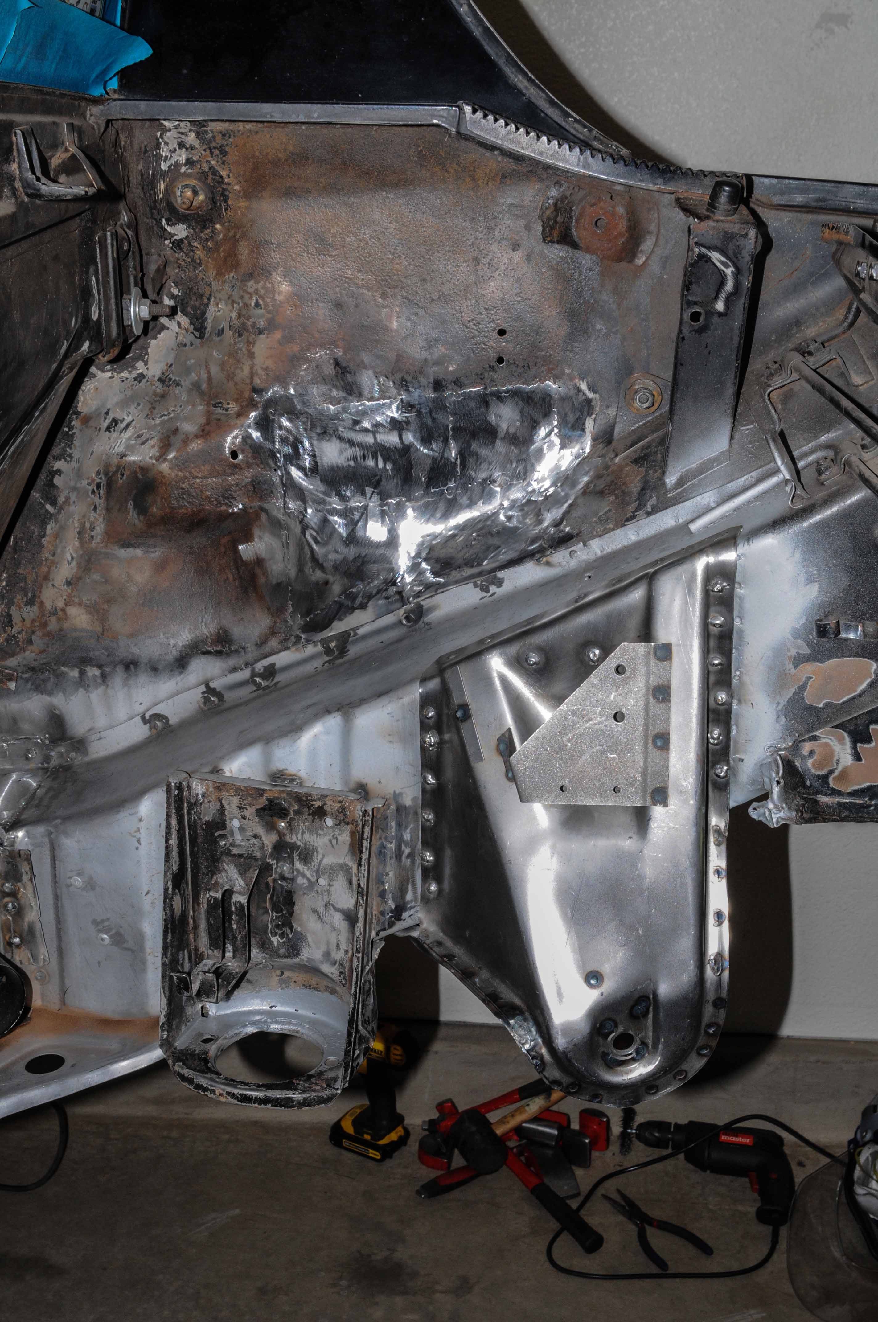

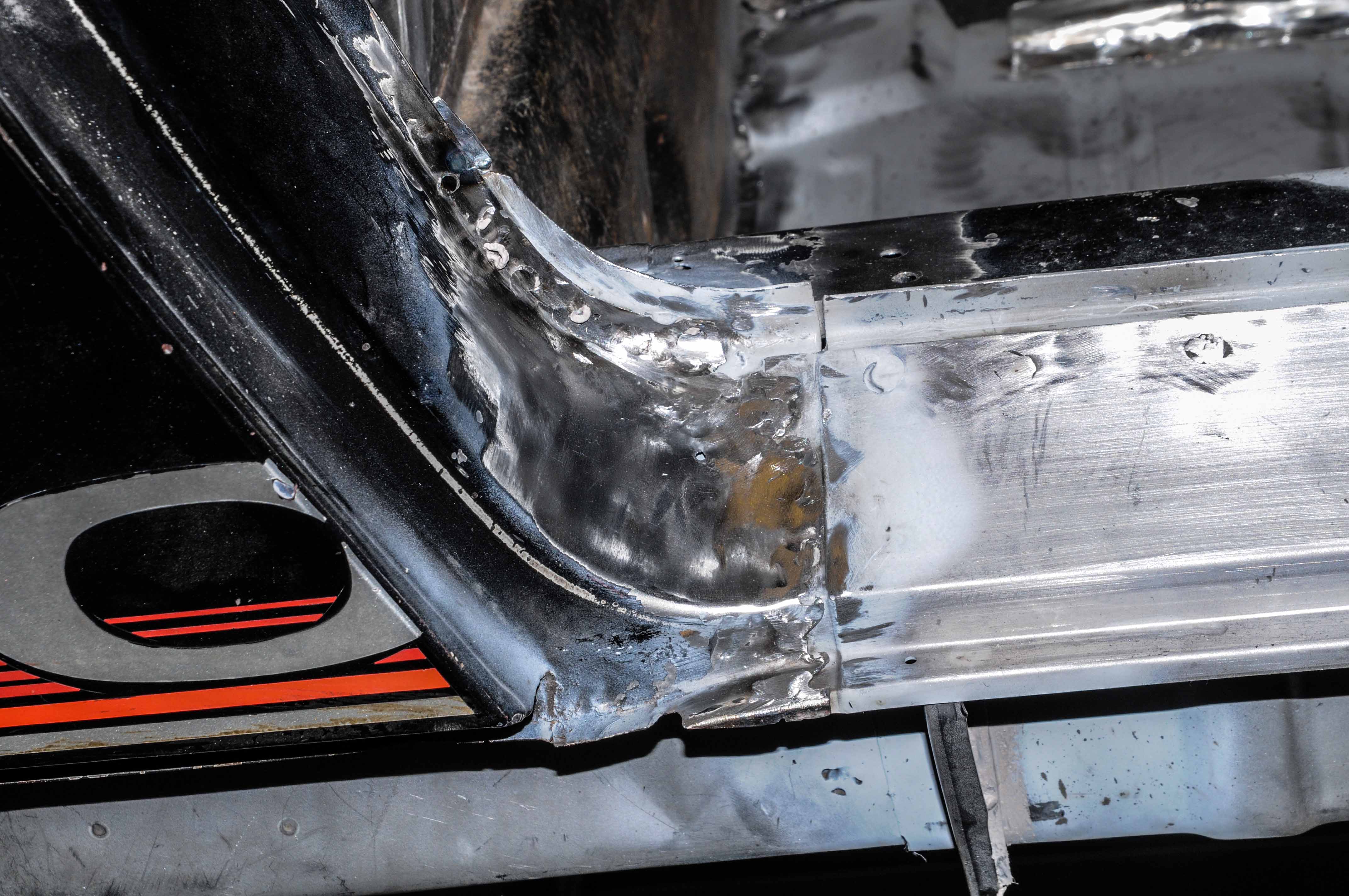

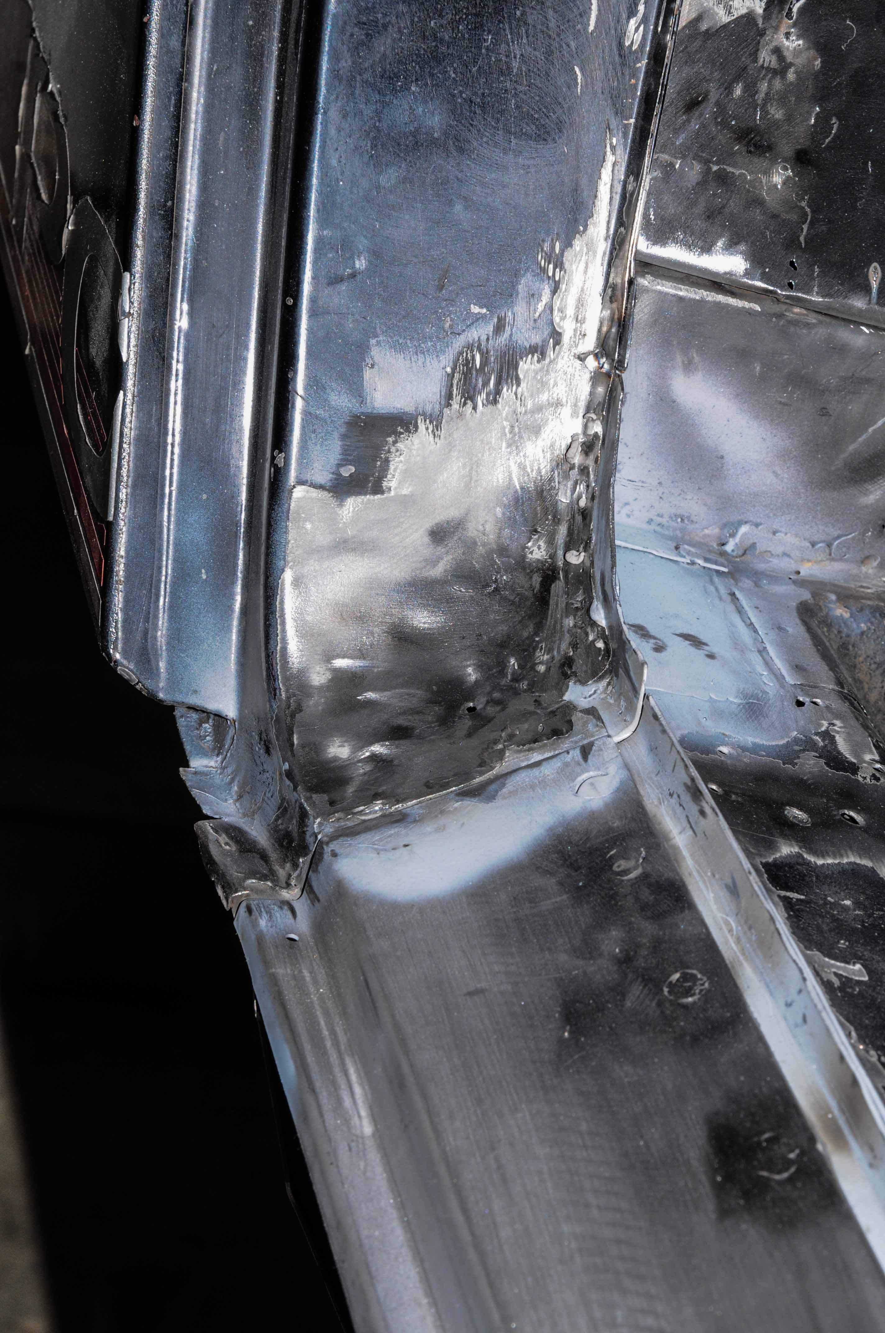

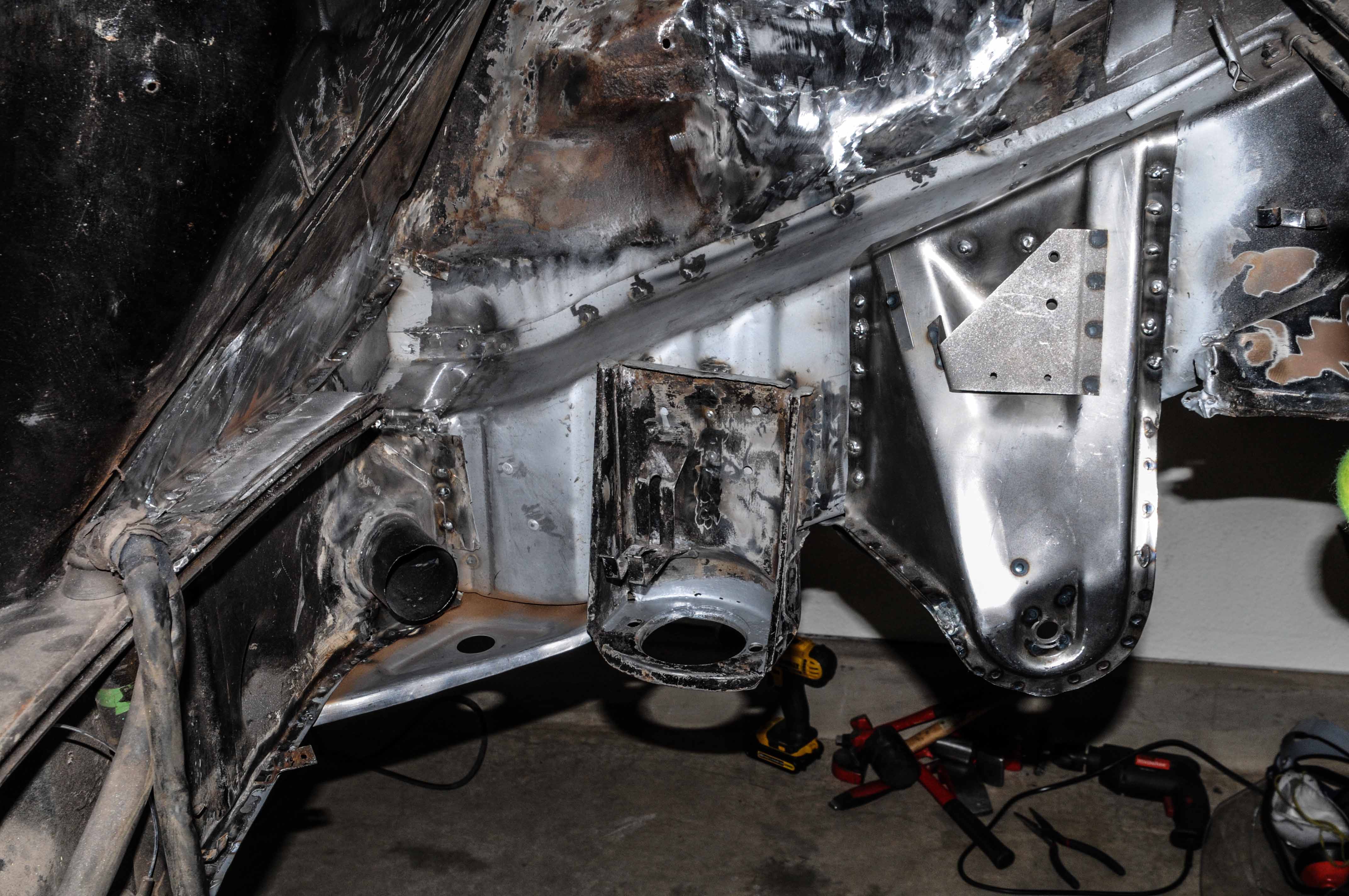

Post for Sunday 29 May:
Shop soundtrack: my Little Richard Pandora station
JUDGEMENT DAY HATH COME!!! ie I finally had the nerve (read no choice on further procrastination) to weld in the suspension console, but only because I finished the other jobs tasks early.
A full day in the garage. I started out welding the triangles under the sill, went on easily. I then decided to play with the door jamb and determine whether it was worth the RD replacement piece for just the bottom 4 inches... So as a test (after wirewheel, sandblasting, ospho, etc) I played around with the hammers and dollies and got the thing well within personal tolerance so I rolled with it. Yeah, there is some metal missing at the bottom edge, but I think I can make this work and still stay on the good side of the 1/8ths inch rule (no filler thicker than an 1/8th inch-but will that still count if I have filler on the underside too?). After more fiddling and welding I decided to waste some time applying seam sealer on the underside, on the triangles' welds, and up in the fender, but when I looked at the clock it was waaay too early to quit, so I turned to the suspension console.
I figured it would take hours to figure out its exact position, adjustments, mounting, and what not and I wouldn't have to deal with the stress of welding on a piece with such exacting tolerances and financial implications. However, the next thing I know,
I have the thing in the perfect position, clamps on and only welding to be done. So I measured a few hundred more times, cracked open another beer, and realized that I had to weld...
As for measuring, I used a triple attack: measuring tape, string, and sticks. As for welding, I was paranoid, so I'd make 2 welds on the opposite ends of each other to prevent heat issues, then measure the thing about 60 times while waiting for it to cool completely. This technique resulted in far more Chuck Berry air guitar singalongs, beer, and cigarettes than planned, but in the end I ended up with a suspension console far within my personal tolerance. From ear to ear I have the perfect 33.5 inches, and from the firewall hole thing to the console ear I'm 1/16th of an inch off, sitting at 28 5/16" instead of the prescribed 28 1/4"! I even added a measurement in which I checked the console's angle and it seemed on the money.
I was completely paranoid of this thing, and whether it was luck or miracle, it really wasn't that bad with rock n roll and paranoid, OCD procedures. This was an extremely fulfilling day, and I feel even better knowing that I can throw suspension, wheels, whatnot on this little car rather quickly and move it if I have to. Maybe I was right in putting off the suspension console so long, or maybe I'm ridiculous for it, who knows? Overall it was a wonderful day in the garage.
